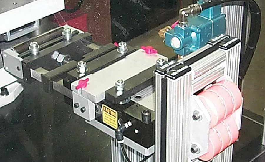

Cutting Compact (Silicon) Discs
Several medical devices feature subassemblies that contain silicon discs. For the last few years, one medical device manufacturer has used a Model No. 34.12 toggle press from Schmidt Technology Corp. to cut 40 to 55 discs per minute from a silicon strip using a steel rule die (also known as a cookie-cutter die). The press also simultaneously punches holes and slits inside each disc.
Dave Zabrosky, North American sales manager for Schmidt, says the machine cuts discs that are 12 millimeters in diameter by 2 millimeters thick, and 0.5 inch in diameter by 0.1 inch thick. Each punched hole has a diameter of 0.06 inch.
The press is housed in a selfcontained workstation that features all-around guarding and is controlled by a PLC. According to Zabrosky, the control system allows for fully automated, single operation and setup modes. Cycle rate is based on a delay timer setting.
An external motorized reel feeds the silicon strip into the cutting die in 0.9- or 0.545-inch sections. After the pneumatic press pushes the material strip through the die, discs and scrap stay on a polycarbonate carrier, and small-hole slugs drop into a catch bin. The processed strip is then automatically moved onto a takeup product reel, where the operator removes the strip.
In fully automated mode, the operator loads the material, closes the guarding and initiates the machine. It stops either when material runs out (via a sensor) or by the operator.
In the single-operation mode, the operator presses the start button to initiate stripping and cutting. This mode is also used to clear the machine of material at the end of a run.
Setup mode is for machine troubleshooting and changing the feeder or die. The latter task takes less than 5 minutes and requires no hand tools.

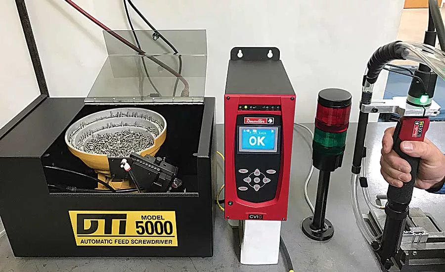

Successful manufacturers of medical devices and equipment know it’s important to always present their products in the best light, both aesthetically and functionally. They also know, thanks to Design Tool Inc. (DTI), the importance of properly presenting screws during assembly to optimize productivity and joint quality.
DTI’s medical industry customers include some of the largest in the industry: Atrion Medical, Stryker, Hill Rom and Carestream Health. Vic Glenn, president of DTI, says some use DTI’s screw presenters, while others use the supplier’s auto-feed screwdriving machines to build high-performance hospital beds and rails, X-ray display screens, plastic pumps, wheelchair assemblies, stretchers, walkers and humidifiers.
According to Glenn, screw presenters are used in fastener applications that are not suitable for auto-feed screwdriving equipment. These include hardto- reach locations and when the fastener length-to-head-diameter ratio is 1-to-1 or less. In these cases, the screw will tumble through a feed tube and not have the correct orientation when it reaches the screwdriver.
DTI’s presenters properly orient and present a screw to a screwdriver equipped with either a magnetic bit or a vacuum pickup attachment. Glenn says that manufacturers like the presenters because they can be used with both pneumatic and DC drivers. They also like that the magnetic bit and vacuum pickup attachment eliminate the possibility of fasteners falling into the assembly.
“Our auto-feed machines are custom built for each medical device application to ensure easy operation and accurate screw location,” explains Glenn. “They feed and drive screws for applications with deep counterbores, minimal screw head clearance and hard-to-reach locations.”
Machines used with DC screwdrivers only feed the next screw when the fastening process is within specification. If the fastening process is not successful, the operator is alerted that the screw is not tightened properly. He can then remove or retighten the fastener before the next screw is fed to the screwdriver.

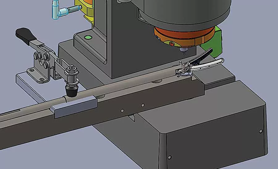

Orbital and radial forming, or riveting, may be mature technologies, but they haven’t remained static. Engineers who typically think of orbital and radial riveting for assembling robust automotive parts need to know that these cold-forming technologies are also effective for small, precision applications, such as medical devices.
One medical device manufacturer is using a servo-driven orbital riveter from Orbitform LLC to rivet small scissors at the end of endoscopic surgical instruments. The joints for these tools pivot on a small stainless steel rivet (0.058-inch diameter) that must be headed to a tight tolerance.
Prior to contacting Orbitform, the company often heard from surgeons about inconsistency in the feel of the tools during usage. The challenge was to come up with a way to form the rivet in the scissors assembly so that the opening and closing of the blade had a consistent feel.
“Due to the stack-up tolerances within the parts in the assembly, conventional riveting to a positive stop was not an option,” says Bryan Wright, vice president of sales at Orbitform. “Instead, we developed a Process Intelligence (process monitoring) method to form the assembly to a specific clamp load. This involved placing a load cell in the riveter’s fixture nest to capture the load force.”
During assembly, the scissors are held stationary, and the riveter advances up from the bottom to form the rivet until the proper clamp load force is achieved. The end result is a pair of scissors with a repeatable opening and closing force that is well within the customers’ required range.

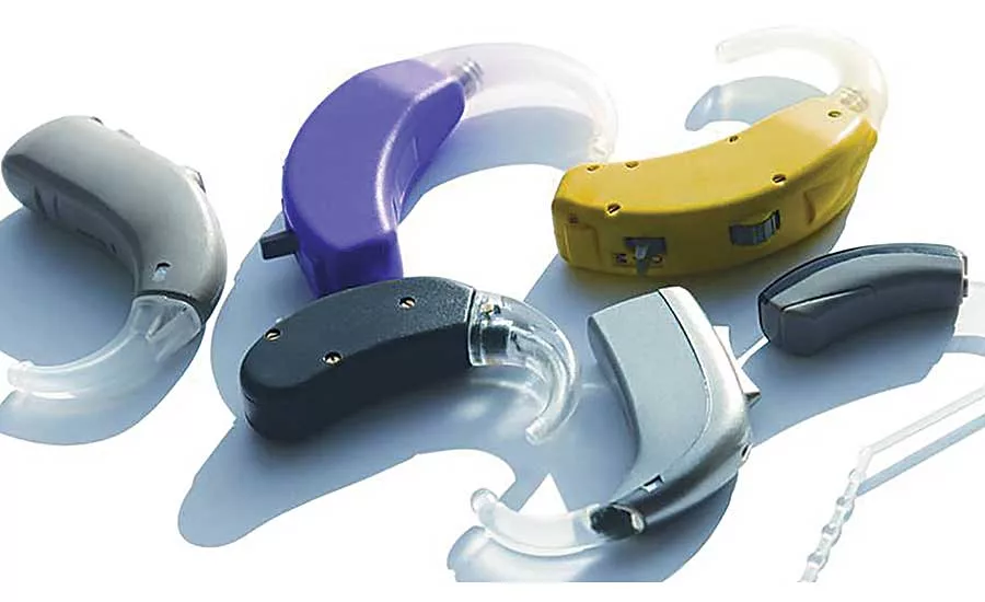

Consumer products continue to get smaller, and medical devices are not exempt from this trend. A good example is hearing aids. Many tiny models can be positioned either behind the ear or inside the ear canal.
A couple of years ago, DEPRAG developed the Nanomat screwdriver that many manufacturers use to assemble hearing aids and other tiny medical devices. Available in both handheld and stationary versions, the screwdriver only produces from 8 to 300 newtonmicrometers of torque, with speeds of up to 2,000 rpm.
Four torque ranges are possible, all of which are applied with a high degree of precision. According to Lori Logan, marketing manager at DEPRAG, hearing aids generally require a torque as low as 10 newton-micrometers, and the Nanomat can achieve that either as a handheld or a stationary unit integrated into one of DEPRAG’s automatic assembly machines.
DEPRAG also makes semiautomatic assembly stations. Logan says one eyeglasses manufacturer uses a station that includes a Micromat EC screwdriver, a process controller, a screwfeeder, a position control stand and electronic measurement controllers. Assembly takes only a few seconds, and involves fastening the arms of the glasses onto the frame with tiny screws that are barely visible to the naked eye.
The screwdriver is the size of a ballpoint pen, but designed to meet industrial demands. Equally important, its torque, rotation angle, speed, standby timing and direction of rotation can be individually programmed (within its performance range) for each screwdriving task.

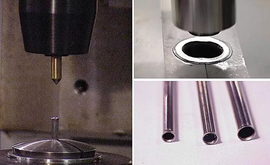

A Flare for Different Devices
Producing catheters with a flared end is more challenging than making those with a straight end. This reality led one catheter manufacturer to ask Orbitform if its orbital and radial technology could flare the end of catheters without cracking the tubing. Wright says the manufacturer reached out a few years ago after reading an application bulletin on Orbitform’s website.
“The customer was press flaring the end of the tube, and this method was causing the material to crack due to excessive force being applied to the part,” says Wright. “Orbital and radial forming, in contrast, induces 80 percent less forming force into the part than the press process.”
After Orbitform’s solution lab successfully processed several sample catheters, the company replaced its press with Orbitform’s B-125 benchtop orbital riveting machine. It features an orbital head and six quick-change fixture blocks designed to handle parts of all sizes.
The manufacturer also integrated the machine with Process Intelligence, Orbitform’s proprietary process monitoring technology. Process Intelligence verifies rivet presence and monitors forming force, pressure, ram stroke distance and other parameters to immediately detect when a catheter is outside the acceptable tolerance range.
