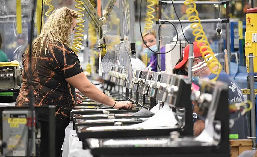

A manual assembly process with low-cost, well-trained talent may have less capital equipment costs, but higher labor costs. Photo courtesy Siemens

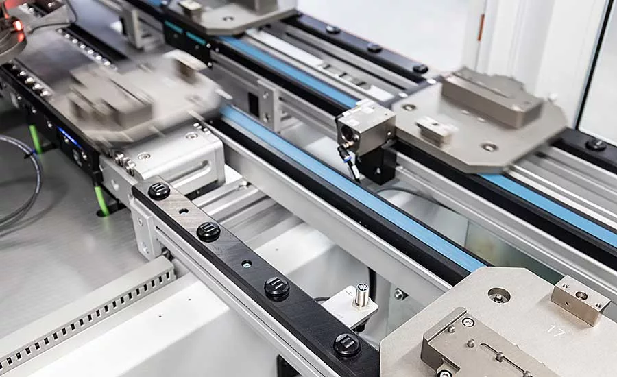

The design of an assembly line should balance the number of parts that can be produced with the cost to develop the line and the price per part. Photo courtesy PARO AG

Organizations often have more than one manufacturing site, and each location might have its own specific strengths. For example, a manufacturing facility with low-cost, well-trained talent may have less capital equipment costs. This manufacturing line will be more labor-intensive. Conversely, the company may have manufacturing sites where the labor cost is too high for the product, necessitating a more automated approach to production. From my experience, large organizations often have both strengths, just not in a single manufacturing line.

Configuring the line for high-volume production will incur costs in equipment or talent. The design of the line should balance the number of parts that can be produced with the cost to develop the line and the price per part.
