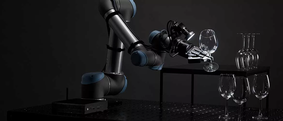

robot handling wine glasses
With the MIRAI control system, a robot can handle items, like these wine glasses, that can vary in appearance based on light conditions in the work space. Photo courtesy Micropsi Industries

German startup Micropsi Industries GmbH has introduced MIRAI, a new control system that enables robots to handle variance in shape, position, color and light conditions in the work space. Using AI, MIRAI generates robot movements in real time and can respond automatically to movements of the target object. MIRAI takes control of the first and last centimeters of the robot’s path, eliminating the need for rigid fixturing of parts.
