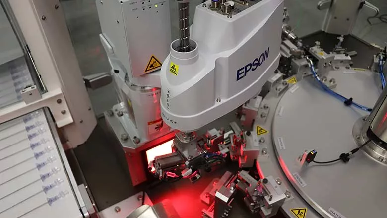

Watching a SCARA robot quickly assemble several small plastic parts, it’s hard not to think of it as a person—a fast, accurate, tireless person, but a person nonetheless.
In reality, equating the abilities of robots and human assemblers is risky. What’s easy for a human assembler can be difficult or impossible for a robot, and vice versa. To ensure success with robotic assembly, engineers must adapt their parts, products and processes to the unique requirements of the robot.

Other guidelines are more specific to robots. For example, unlike human assemblers, most robots cannot hold a part in one hand and a tool in the other. Rather, SCARA and Cartesian robots are “one-handed,” and they can only move along three or four axes. As a result, products should be designed so they can be assembled in layers from the bottom up.
“If the product has not been designed for robotic assembly, you often see that it has to be accessed from multiple sides,” says Dumont. “You want everything to be accessible from the top.”
Reorienting an assembly adds cycle time without adding value. It also increases the cost of the fixtures. And, instead of a SCARA or Cartesian robot, assemblers may need a more expensive six-axis robot.
For similar reasons, parts should be designed to stay in place after they are installed by the robot. Better still, parts can be designed with snap fits, eliminating the need for fastening, welding or bonding later. In addition, because robots cannot move with the same repeatability as dedicated, “hard” automation, parts should have self-aligning features, such as lips or chamfers, to help the robot insert them.
“One of the first things to consider when you’re designing an assembly is, ‘Do the components want to go together?’” says Phil Baratti, applications engineering manager with Epson Robots. “If you have to force parts to fit when they should just fall into place, then you can have trouble with automated assembly.”
