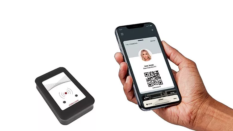

Use the right access control technology. RFID or mobile credentials using BLE or NFC are more secure, reliable and convenient than password or PIN systems for machine authentication. An RFID badge or token is usually the preferred choice in a factory environment. Smartphones may be a safety or security risk on the factory floor and can be damaged in dusty, hot or humid factory environments. Since most manufacturers issue a corporate ID card for building access and security, it makes sense to leverage the same card for machine access.
Choose transponder technologies and encryption suitable for the application. Communication between the RFID tag and the reader should be encrypted to prevent eavesdropping and credential cloning. In general, high-frequency (HF) RFID technologies, which operate at 13.56 megahertz, allow for more advanced encryption and longer encryption keys than low-frequency (LF) RFID technologies, which operate in the 125 kilohertz range. Well-known transponder technologies such as MIFARE, LEGIC and HID Prox or iClass offer a range of security features and encryption options. For machine authentication, look for a reader that supports at least 128-bit encryption, such as AES-128. Some readers now support advanced elliptic curve cryptography (ECC) for an even higher level of security.
NFC is usually preferred over BLE for facilities supporting smartphone authentication use. NFC credentialing mimics an HF RFID signal on the same 13.56 MHz band. Compared to BLE, NFC has a much shorter read range (a few centimeters vs. up to 100 meters), which ensures users are in close proximity to the machine or device they are unlocking. The short read range prevents others from piggybacking on the proximity of users who are in the vicinity but not actively using the machine. It also reduces signal eavesdropping risks. NFC supports strong encryption, just like HF RFID. A universal reader, such as those available from ELATEC, enables manufacturers to support smartphone credentialing, LF or HF RFID, and even newer interoperable and open standard credentials, such as LEAF or those based on public key infrastructure (PKI), providing maximum flexibility.
For even higher security, consider adding two-factor authentication. This can be accomplished, for example, by requiring both a password and an RFID token to log into the machine. Smartphone credentialing allows for an additional layer of security through the device itself; biometrics (facial or fingerprint recognition) can be turned on for the phone, ensuring that only the phone owner can open the credentialing app.
