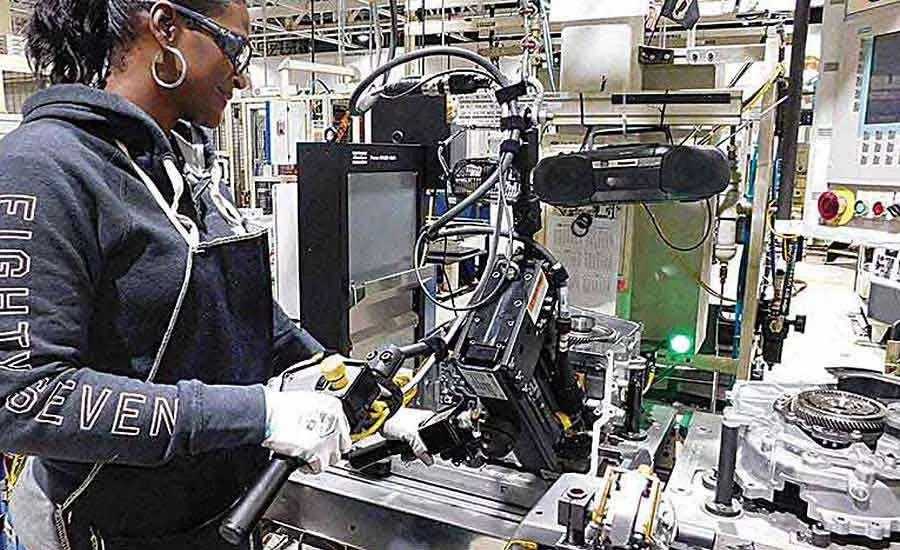

Ironically, this is particularly true for manual production. People still play a primary role on assembly lines, especially when assembling complex mechanical products, such as gearboxes. But, as product complexity and variety increase, so, too, does the amount of information assemblers must process and thus, the risk of errors.

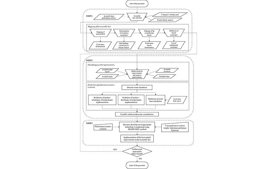

Our methodology for choosing the most appropriate Industry 4.0 technology for an assembly line is a three-step process, as shown in Figure 1.
The first step is to identify the assembly line that needs improvement in accordance with company metrics and strategic aims. Common problems include unbalanced workflow, a high percentage of manual tasks, excessive physical or mental workloads, process time variations, and long lead times.
Next, engineers should conduct material and information flow mapping to evaluate the current situation, detect specific issues, and determine possible areas for investment. In addition, constraints and the line layout should be evaluated. The goal is to get a clear idea about the performance of the line and its strengths and weaknesses.
Before implementing any Industry 4.0 technologies, engineers should first attempt to correct any problems using conventional methods, such as standard work, line balancing and ergonomics. Such actions will invariably improve key performance indicators (KPIs) and serve as a foundation for further improvements.
Next, engineers should consider the limitations and possibilities of the assembly line, as well as available resources and the company’s strategic goals. From there, a list of technologies that could help can be identified. These technologies will then be ranked according to the KPIs and strategic goals. Tools such as discrete event simulation can be used to predict the outcomes of implementing each proposed technology.

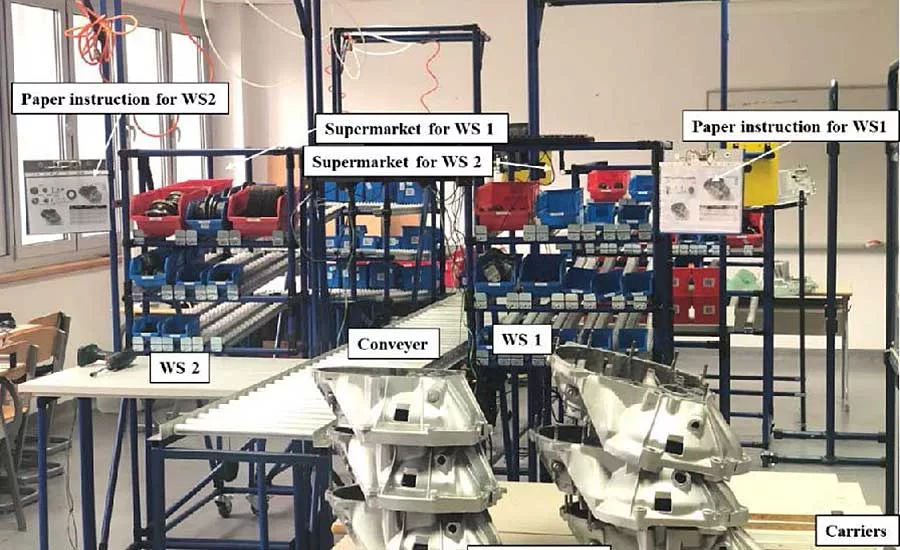

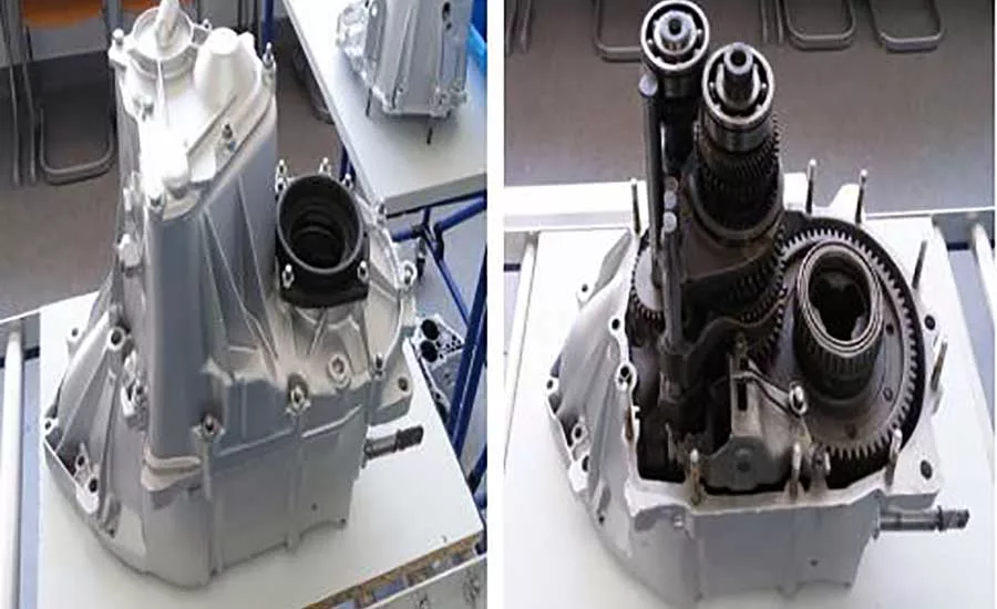

To validate our decision-making system, we created a model assembly line to produce automotive gearboxes at the university’s Learning Factory, a demonstration facility for testing new technologies and teaching lean manufacturing concepts. The assembly line consists of five workstations.
The gearbox comes in two base models. With various options, the gearbox can be made in 20 variations. The gearbox contains a huge amount of gears, levers, screws, shafts and other parts. It is assembled in five steps. Each step is assigned a certain amount of work, and each step takes place at one workstation. Each workstation contains real hand tools and supermarkets with real parts. The workstations are connected with a conveyor.

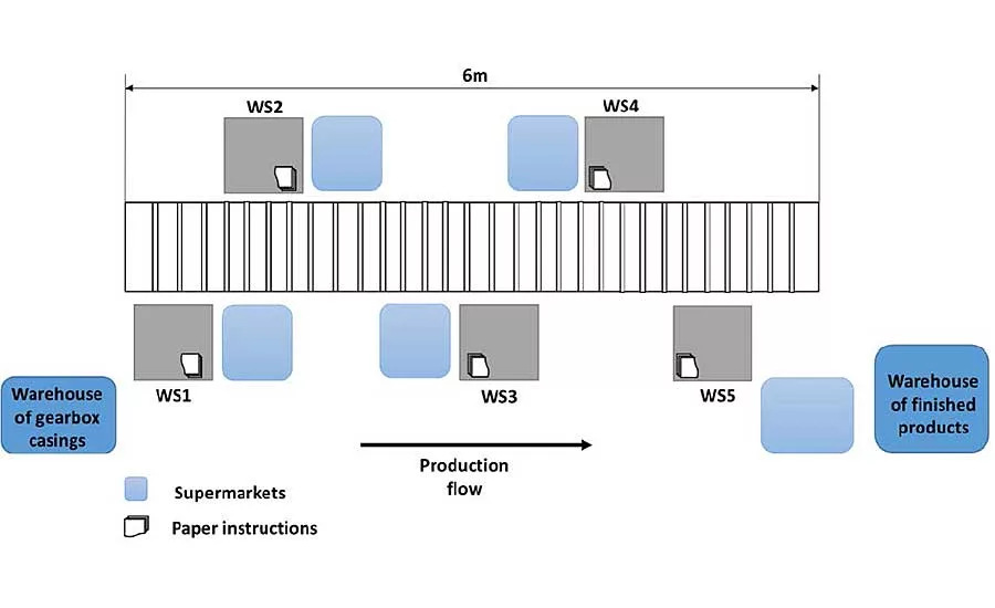

Initially, the gearboxes were assembled manually using paper-based work instructions and manual data gathering. Initial attempts to balance the line found huge discrepancies in cycle times among the workstations.
Industry 4.0 technologies could help. Given the possibilities and limitations of the line, such as space and resources, seven Industry 4.0 technologies were considered: RFID, digital work instructions, pick-to-light technology, AR, cobots, automated guided vehicles, and ergonomic manipulators.

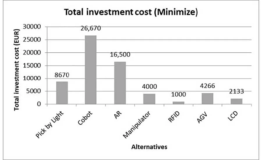

The PROMETHEE method was used to evaluate the seven technology possibilities for improving our gearbox assembly line. Four quantitative criteria were used to rank the technologies: total investment cost, worker effort, workspace utilization and cycle time reduction. Two of the criteria were to be maximized—cycle time reduction and worker effort reduction—while the remaining two were to be minimized.

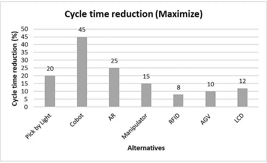

Cycle time reduction is one of the main aims of implementing I4.0 technology, since total production time depends on the workstation with the highest cycle time. To collect cycle time data, discrete event simulations are usually used. In our case, however, we used data directly from our model assembly line.
The total investment cost is mainly affected by the price of available equipment.

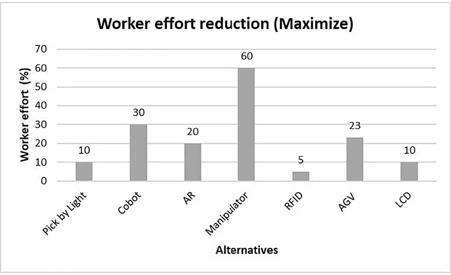

Worker effort values are estimated according to the workers’ experience. This data was obtained through interviews with workers. (Worker effort can be more precisely calculated through the use of sensors or cameras that provide quantitative data on heart rate or body movement.)

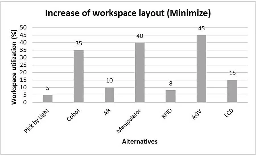

Implementation of new technology invariably leads to a change in how an assembly line or an individual workstation is laid out. Sometimes, more space is needed—for example, to accommodate a robot. In other cases, less space is needed.

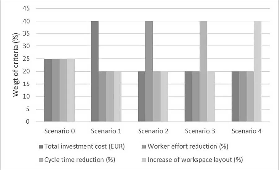

For our study, five criteria weight sets were used. Each weight change refers to one scenario. The first scenario (Scenario 0) is an alternative where each criterion has equivalent weight. In the other four scenarios, one criterion was assigned twice the weight value of the remaining criteria (Scenarios 1-4).
Within PROMETHEE, we used the linear preference function with defined indifference and preference thresholds for all criteria. The linear preference function is recommended for quantitative criteria when an indifference threshold is to be defined. The indifference threshold is the largest deviation that the decision-maker considers negligible, while the preference threshold is as the smallest deviation sufficient to generate a full preference of one alternative.
For example, for the criterion “total cost investment,” the indifference threshold and preference threshold are set to 135 and 667 euros, respectively. If the difference in price between the two alternatives is below 135 euros, both alternatives are equally preferred. However, if the price of alternative 1 is cheaper than alternative 2 by 667 euros or more, alternative 1 is preferred over alternative 2.

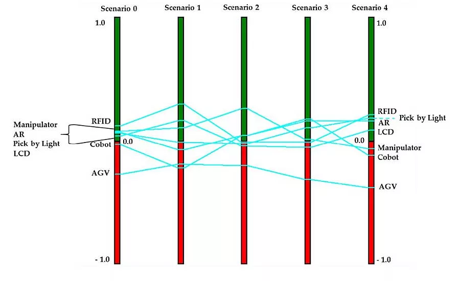

Figures 5, Figure 6 and Table 1 are input data for the PROMETHEE method, which was run for each scenario separately. The best technology alternatives for each scenario are compared in Figure 7.
From our rankings, it’s clear that RFID presents the best compromise in scenario 0, because it is the cheapest option that does not increase the layout significantly. Furthermore, RFID is the best compromise in scenario 1, which emphasizes cost reduction. This is expected since this option is the cheapest of all the technology alternatives. RFID is also the best compromise in scenario 4, in which the criterion “layout increase” is minimized, because this technology requires the least amount of space to implement.
On the other hand, cycle time reduction and worker effort were important in Scenario 2 and Scenario 3, respectively. Therefore, the cobot was the best option in Scenario 2, since this technology significantly reduces the cycle time.
Because of the enormous reduction of worker effort, the manipulator came out as the best option for Scenario 3.
It is surprising that AGVs come last in most scenarios. It can be a little bit confusing, given that this technology is highly used in industry today. One possible reason may be that these technologies could not be effectively represented in our criteria.
Our analysis emphasizes the importance of decision-makers’ preferences, expressed through the weights of the selected criteria. This analysis also emphasizes the need for individual definitions of criteria according to the needs of the enterprise. When choosing and defining criteria, and assigning them weights, each enterprise must proceed with caution. A team approach and mutual agreement are well-advised.
