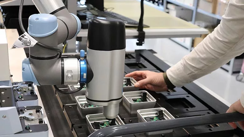

application cell
The application cell is equipped with an OnRobot screwdriver, two screwfeeders, fixtures, rolling tables and Universal Robots’ UR5e cobot arm. Photo courtesy OnRobot

The application cell is equipped with an OnRobot screwdriver, two screwfeeders for handling precoated M3 and M6 screws, product fixtures, rolling tables and Universal Robots’ UR5e cobot arm.
