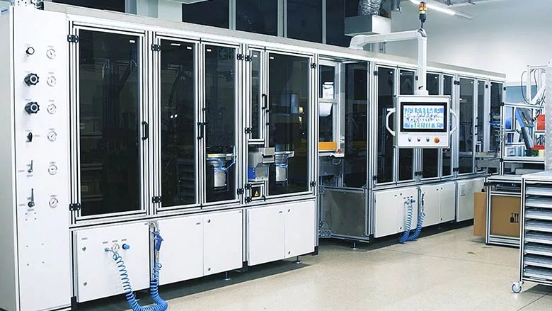

automated assembly line
This automated line consists of 20 stations, including stops for assembly, punching, measuring springs, calibration, visual inspection, screwdriving and marking.
Photo courtesy Bosch Rexroth Corp.

“We needed a line with 20 stations, including assembly, punching, measuring springs, calibration, visual inspection, screwdriving and marking,” explains Scheffner.
