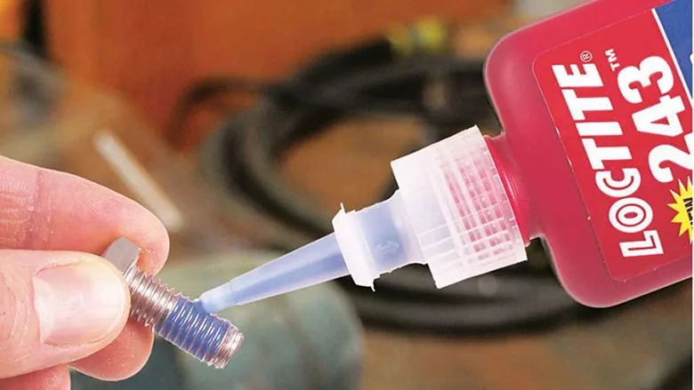

Threadlockers and retaining compounds have been around for decades. Officially known as anaerobic adhesives, the materials cure in the absence of air, filling gaps between components.
The one-part formulations are ideal for mechanical fastening applications. Anaerobics are commonly used for locking tasks that involve bearings, bolts, nuts, pulleys, screws or shafts. In addition to tight bonds, they also have sealant properties and can protect bolted assemblies from liquid and gas corrosion.
Anaerobics are popular because they protect against vibrations and seeping fluids to keep metal assemblies holding fast. They enable engineers to design robust, lightweight joints at less cost than traditional interference fits.

Anaerobic adhesives enable engineers to design robust, lightweight joints at less cost than traditional interference fits by reducing dimensional precision and increasing the selection of viable substrate materials. They provide strength and reliability and are traditionally used to secure bearings, bushings, cylindrical parts and gears onto housings or shafts.
Anaerobics are structural adhesives that polymerize when the liquid is confined without air between close-fitting metal surfaces. The first and best-known use for anaerobic adhesives is thread-locking, in which a drop of adhesive applied to the threads of a nut and bolt bonds the assembly, prevents vibrational loosening, seals the threads against fluids and moisture, and prevents corrosion and rusting.
Many engineers embrace anaerobic threadlockers as a chemical solution to the mechanical problem of loosening.
