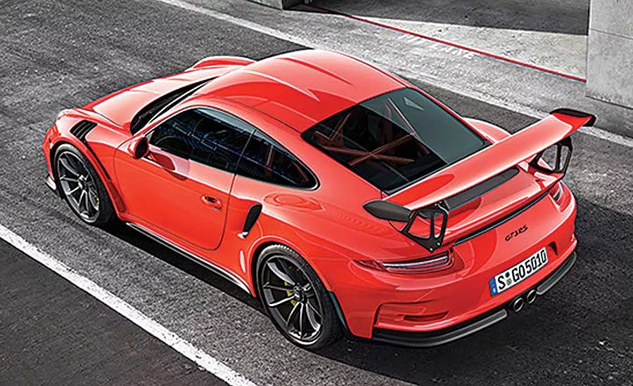

The Porsche 911 features a roof made out of magnesium. Photo courtesy Porsche AG

Currently, magnesium components account for only 1 percent, or 33 pounds, of a typical car’s weight. Most applications have been confined to expensive sports cars, such as the Porsche 911.
