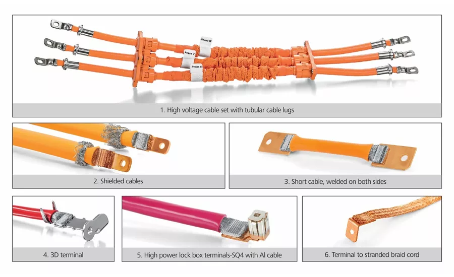

Many joining applications that were impossible for longitudinal welding are now possible. In fact, torsional welding is sometimes the only method for welding high-voltage cables or EV batteries. The process can weld copper cables up to 160 square millimeters in cross-section and aluminum cables up to 200 square millimeters in cross-section. Torsional welding is ideal for bus bars, 3D terminals and integrated gate bipolar transistors (IGBTs). And, since the closing movement of the welding system only takes place in the Z axis, the system is easily accessible and enables short cycle times.
Short cables can be welded on both sides. This is a problem for longitudinal welding systems, because applying vibrations to the second weld can break the first weld. Torsional welding has much less vibration, so it’s possible to weld cables as short as 4 inches long.
The process can be used to weld high-power lock-box terminals, as well as to weld terminals to stranded braided wire. The latter can have very fine strands that can be damaged if not for the gentle vibrations of torsional welding.

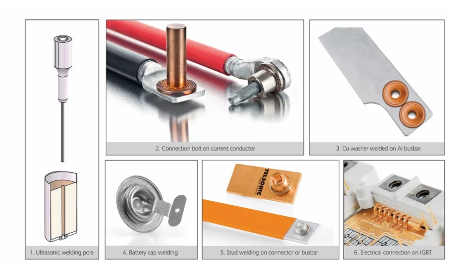

Torsional ultrasonic welding is used in myriad other EV applications, including:
  • Some cylindrical EV batteries require a metal pole to be inserted through a “jelly roll” of coated foil and welded to the bottom of the cell. As a result, the ultrasonic welding tool must have a long reach. Torsional ultrasonic welding does the job.
  • Flexible bus bar foils are laminated or plated with materials, such as copper, to prevent issues with oxidation. For solid bus bars, there must be plating for the bolt hole connection section. For aluminum bus bars, the contact for connection must be copper. Therefore, a copper washer is used and connected to the bus bar with torsional ultrasonic welding.
  • Components such as air bag sensors are designed as cylindrical can assemblies. Torsional ultrasonic welding can create a hermetic seal on such assemblies.
  • Welding studs on a connector or bus bar.
  • Electrical connection on IGBTs. Torsional ultrasonic welding can be used to weld conductors to the copper-plated ceramic circuit board in IGBT modules. The gentle vibration allows more consistent welds without damaging the ceramics. The process is also used to create fine wire bonds for digital brake controllers.
