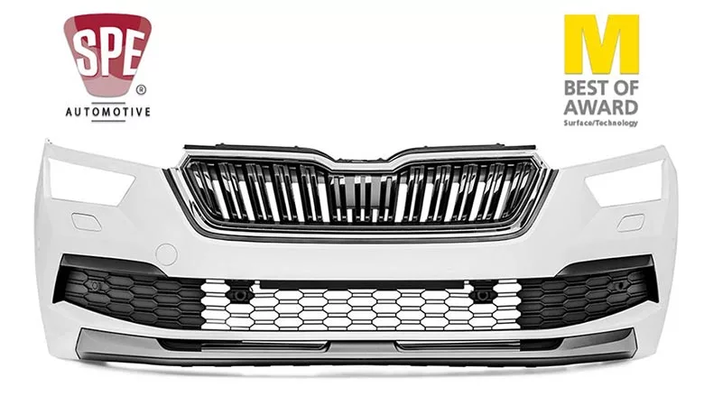

Torsional welding won’t mar Class A surfaces.

Torsional welding can be used in applications that were deemed either impossible or unacceptable over the last decade. Even painted plastic parts can be joined securely and safely without leaving visible indentations.
Today, technology is increasingly being used in EV manufacturing. To reduce weight, class A surfaces are becoming thinner. Linear ultrasonic techniques have traditionally been used to weld substrates greater than 3 millimeters thick. Now, however, those same substrates are as thin as 2.5 millimeters thick. This is where torsional welding has proven to be particularly advantageous.
