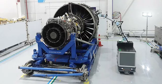

mobile cobot inspects a jet engine

Robots are used throughout Pratt & Whitney’s manufacturing facility in Singapore. Here, a mobile cobot inspects a jet engine.
Photo courtesy Pratt & Whitney
