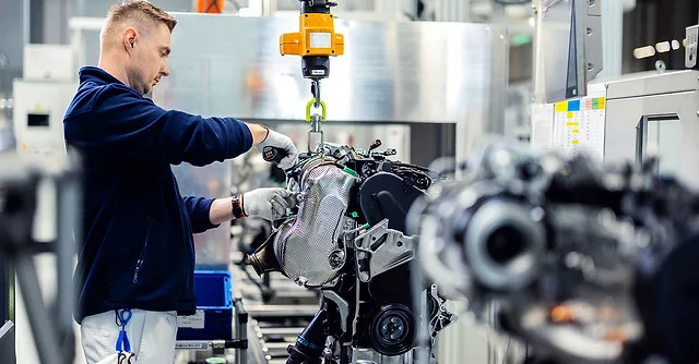

employee working on an assembly line
New technologies, such as wearables and the Industrial Internet of Things, make it possible to monitor workers’ cardiorespiratory health on the assembly line in real time. Source: Volkswagen
