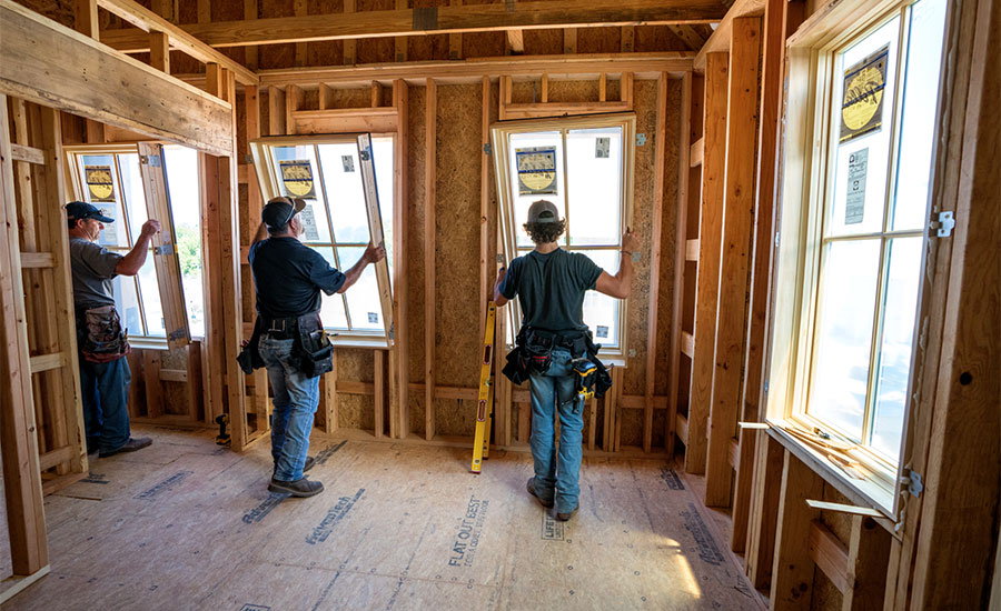

One of Pella’s biggest innovations in recent years is Steady Set, the fenestration industry’s first interior installation system for wood windows. It is designed to make the process safer, faster and more precise through smart, intuitive components.
After months of jobsite observations, Pella engineers discovered that 85 percent of installers were setting windows from the interior of homes, despite products being designed for exterior installation.
This insight led to an ambitious R&D project that culminated in an ingenious product that combines interior clips and a flexible exterior fin with continuous corner seals, sill shims and a head stabilizer.
A head stabilizer engages with the rough opening header to help temporarily stabilize the unit, eliminating the need for someone to hold the unit from falling inwards prior to fastening. A pop-up yellow fin deploys easily after the window is set to help ensure an exterior water barrier after being flashed. In addition, a flexible hinge adapts to wall variation and an integrated corner seal provides a continuous seal.
Pre-attached brackets securely attach the window to the rough opening and make an audible click upon reinsertion for installer confidence. Pre-applied sill shims also raise each unit 0.25-inch off the rough opening sill, allowing tools to be easily inserted to manipulate the unit, eliminating pinched fingers and damage when leveling.
Steady Set streamlines the window installation process, making it more than three times faster than traditional installs. In addition, crew exposure to the elements is reduced by 72 percent and 64 percent of the install process can be completed from indoors.

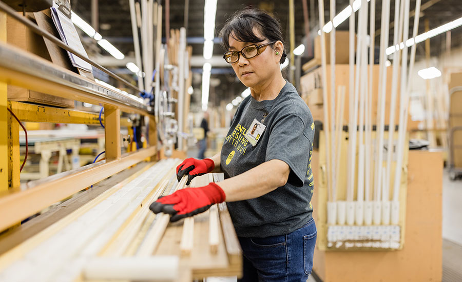

 wood processing operation
Pella’s world-class wood processing operation handles thousands of feet of lumber every day. Photo courtesy Pella Corp.

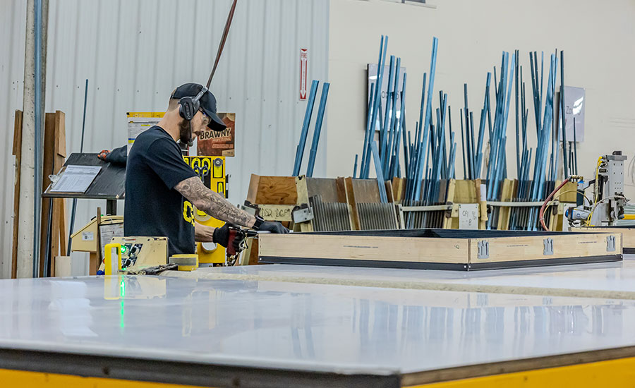

Assembly Variables
In addition to several core factories scattered throughout Iowa, Pella has assembly plants in Arizona, California, Florida, Illinois, Kentucky, North Carolina, Ohio, Oregon, Pennsylvania, Texas and Wisconsin. Its flagship factory in its namesake city specializes in assembling doors and fixed wood windows.
 This is our largest manufacturing site,” says Phillips. “We have a lot of vertical integration here. Many parts we produce in Pella are shipped to our other plants.”
The 1.5-million-square-foot facility features nine assembly lines, with three additional value-add areas for custom products. Assemblers use a mix of manual and semiautomated tools, including nail guns and DC electric screwdrivers.
Pella also maintains an in-house print farm that uses additive manufacturing to create manual assembly devices such as drill guides, fixtures, pry tools and weatherstripping installers.
“Our ‘ready to build’ approach uses tools like voice-to-pick and defect detection in parts making, so when units enter the line, [engineers and operators have] a high level of confidence they’ll move through without rework or interruptions,” explains Phillips.
“Attribute-based workstations break the build process into manageable steps, allowing team members to focus on the specific details that matter for quality,” Phillips points out. “Digital work instructions and system-enabled checks support accuracy while reducing training complexity.
“The way our assembly lines are laid out is dependent on the complexity of our products and processes, as well as our continued evolution as a manufacturing business,” notes Phillips.
“In some areas, we’ve been able to move toward cellular manufacturing as a way to maximize the use of our assets and create flexibility to handle shifts in product mix and demand,” explains Phillips. “This requires more standardization of product designs and more flexible equipment as an enabler.
“In other areas, value stream complexity or unique product designs can drive us toward linear flow,” says Phillips. “We still have many areas that operate with linear flow through parts fabrication and assembly using more dedicated equipment.”

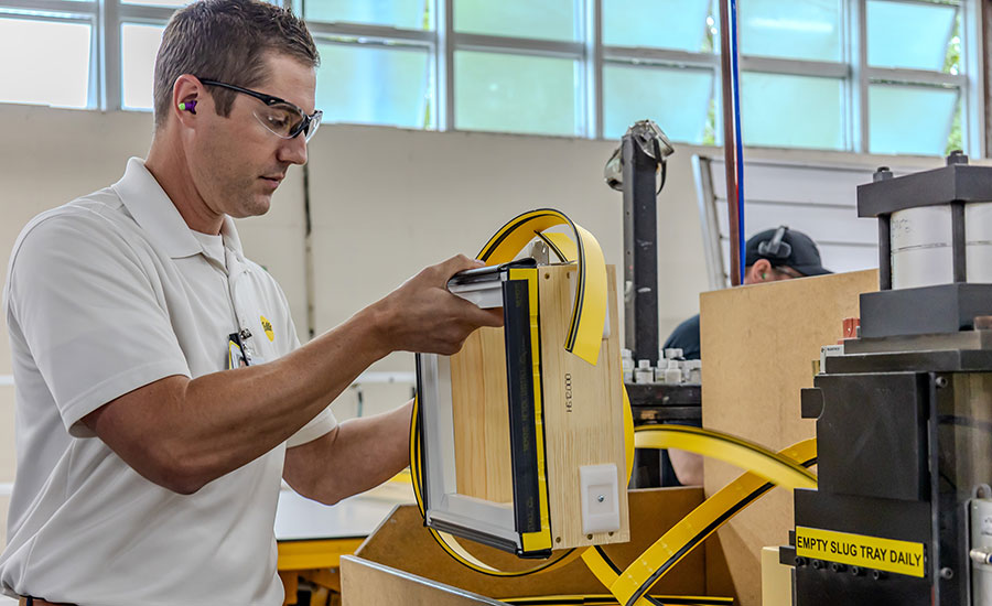

While doors and windows are assembled using similar tools and production processes, size is the biggest difference.
“The number of physical pieces or how they fundamentally go together isn’t significantly different in a door vs. a window,” claims Phillips. “But, many of our processes—especially in parts making—are driven off a lineal foot measure, not piece. For example, it takes twice as long to mold, dip, sand, interior finish and apply a glazing sealant bead on an 8-foot part vs. a 4-foot part.
“From an assembly standpoint, where it might take two screws to install a lock in a window, it can take 10 in a door.,” explains Phillips. “Each workstation has to be three or four times larger for a door vs. a window.
“Combine that with significantly fewer doors in each job than windows, and you get longer takt times on a door assembly line,” says Phillips. “All that can net out to a more complex list of jobs an [operator] has to train on and master in one role in door production.
“When Steady Set was introduced, we initially implemented it in an offline beta cell to validate the process,” notes Phillips. “As demand grew, we transitioned to installing it directly on our assembly lines.
“This required some targeted updates—adding fixtures, gauges, hand tools and part-processing equipment—to ensure smooth integration without major layout changes,” says Phillips. “We also added digital verification systems to ensure that every Steady Set unit has installation hardware that is configured correctly for the customer.”
More than 90 percent of production activity at Pella’s flagship factory involves build-to-order products. That presents a unique set of challenges for Philips and her team.
“Build-to-order manufacturing is about delivering for our customers,” explains Phillips. “Because every order is unique, our teams manage variability in product configurations, schedules and material needs.
“Lean inventory requires precise timing to ensure the right parts are available, and meeting tight lead times means we must respond quickly when plans change,” notes Phillips. “Customization also raises the stakes for quality, making real-time visibility into order status and performance essential.”

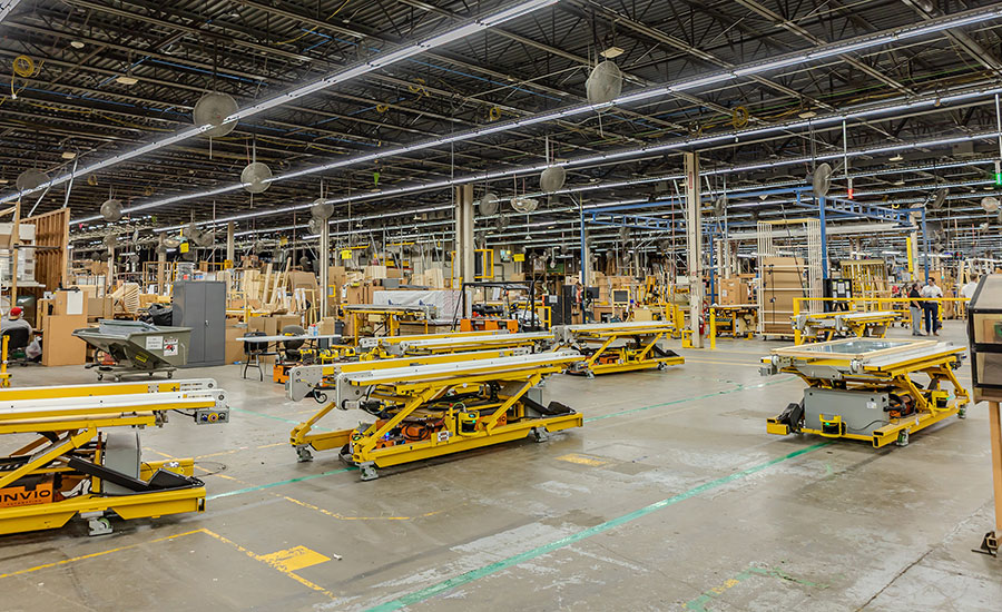

A fleet of automated guided vehicles are used to produce doors. Photo courtesy Pella Corp.

Pella began investing in robots several years ago to eliminate complexity and repetitiveness on the factory floor. Employees who were once manually sanding wood window and door frames, for example, were able to move into less physically demanding roles for equal or higher pay.
“Our automation and robotics improve efficiency and consistency, but the real advantage comes from designing the system to produce the right result the first time,” claims Phillips.
In early 2025, the sliding door assembly department implemented an automated workcell that features six-axis robots and automated guided vehicles. Ten robots and a fleet of 28 AGVs assemble and transport door panels that can weigh up to 300 pounds each.
The AGVs address ergonomic concerns by automatically adjusting to the preferred operator height. They also help prevent dents, dings and scratches that were sometimes caused by traditional material handling methods.
“Real-time visibility into what’s on the line, station by station, helps us balance flow and build the exact mix customers need,” says Phillips. “Automation also produces detailed unit-level data and cycle times, giving our teams the insights they need to drive ongoing improvements as production scales.”
Another robotic assembly application at Pella is a 3D inline bead inspection system that ensures consistent sealant is applied to windows. A state-of-the-art AI-based vision and adaptive process control system inspects the bead in real time, capturing 400 images per second along the entire dispensing path. It automatically detects even the smallest gaps or inconsistencies in the sealant bead, eliminating potential leaks before they happen, while improving throughput and overall production efficiency.
Safety is always the No. 1 priority in Pella’s factories. Whether it’s air tables to reduce the forces required to move a product from one station to another or utilizing powered tilt tables and overhead manipulators, safety is the focus of every automation initiative. That was one of the reasons why Philips and her manufacturing engineering colleagues decided to incorporate AGVs into the new wood door assembly system.
“It’s flexible, which enables us to build sliding doors, front doors and hinged patio doors all on the same line,” says Phillips. “With attribute-level scheduling and workstation routing, we can handle a ton of variation while not being constrained by one attribute.”
