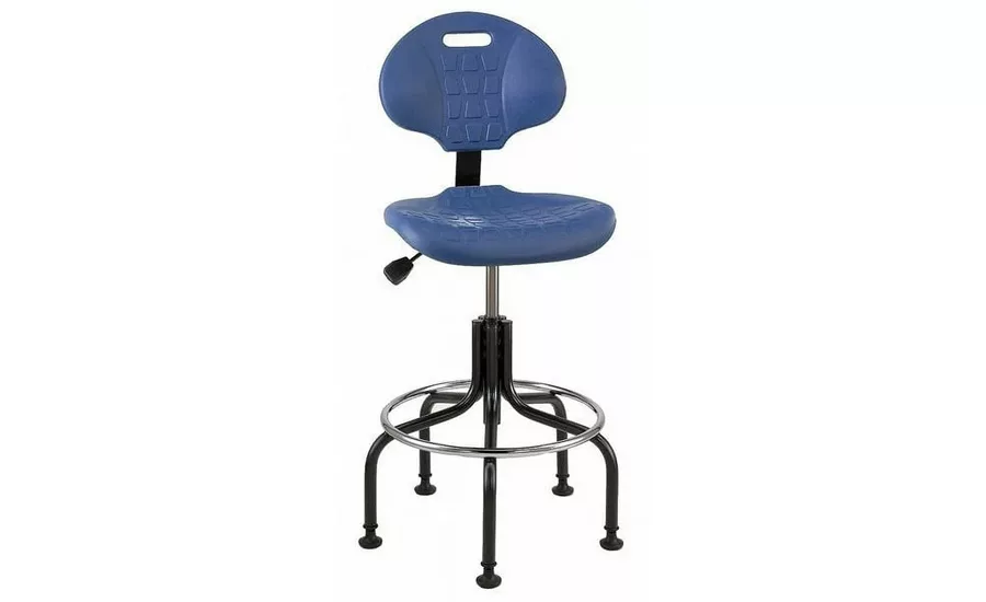

The right type of chair or stool can help address ergonomic concerns.
ergonomic-work-chair
Bevco Ergonomic Seating
Photo courtesy Bevco Ergonomic Seating
