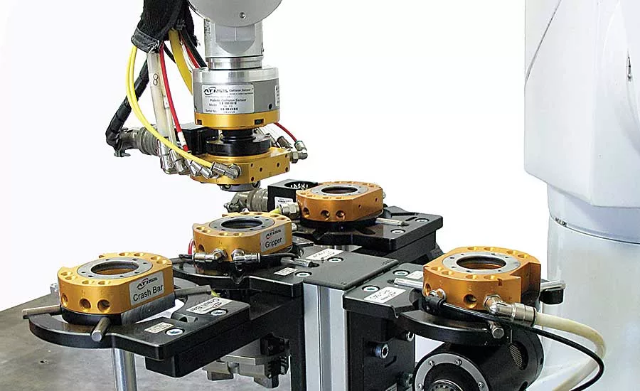

Robotic tool changers provide flexibility to robotic applications by enabling the robot to change end-effectors automatically (e.g.; grippers, vacuum cup tooling, pneumatic and electric motors, weld guns, etc.). Tool changers consist of a master plate, which is mounted to the robot arm, and a tool plate, which is mounted to the end-effector. The tool changer passes utilities such as pneumatics, electrical signals, fluids, and more from the robot arm to the end-effector.

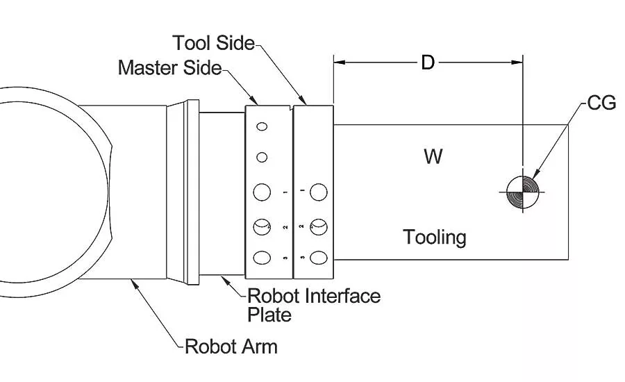

Calculating the Static Moment Load
The most accurate selection of a tool changer model is made by calculating the static moment load of the end-effector.
Use the following to approximate the worst-case static moment:
a) Find the approximate center-of-gravity (CG) of the heaviest end-effector to be used.
b) Calculate the distance (D) from the CG to the mounting face of the tool plate (example right).
c) Calculate the weight (W) of the heaviest end-effector.
d) Multiply W by D to get an approximate static moment (M) (or a moment based on one G of acceleration).
e) Select a tool changer with a static moment capacity equal to or greater than M.
Typical robot motion produces moments two to three times higher than the calculated static moment (M) due to their high acceleration. In order to ensure proper functionality and longevity, the selected tool changer must be designed to handle dynamic moments three times higher than their static moment ratings.
