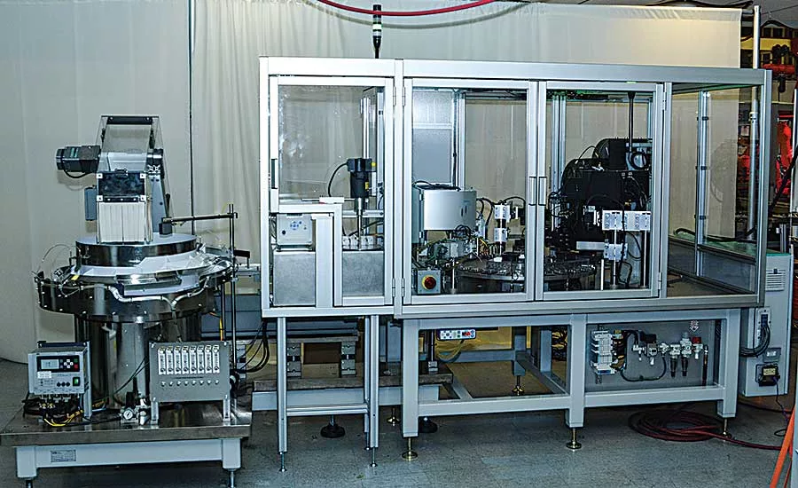

Reduce technical and schedule risk by determining early if development efforts have an unrealistic schedule or a high probability of failure. Photo courtesy CAID Automation
