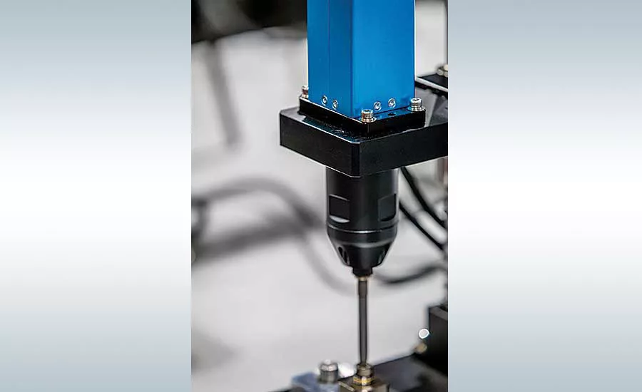

Electric torque screwdrivers are available that are designed to work with, or that can be adapted to work with, robotic assemblers. Photo courtesy Mountz Inc.

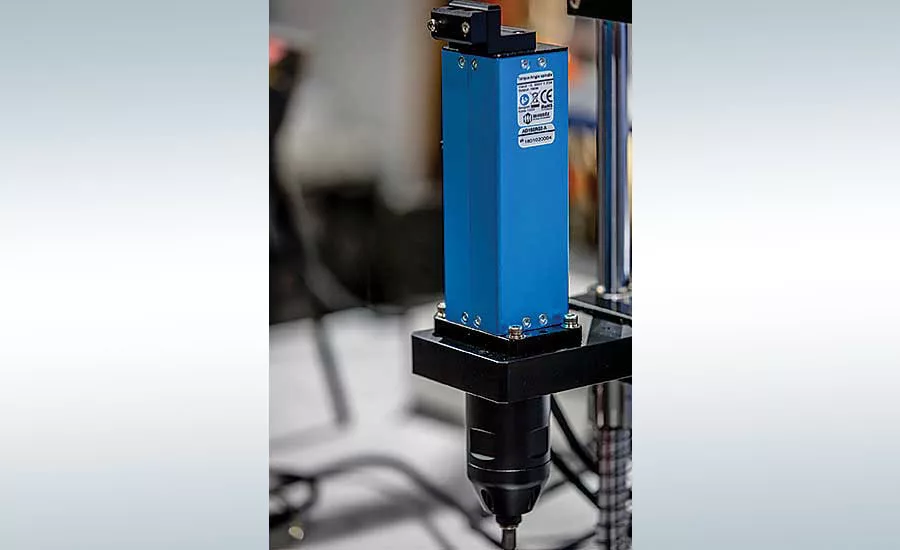

To maintain consistent accuracy, torque tools must be checked periodically for wear or defective parts. Photo courtesy Mountz Inc.

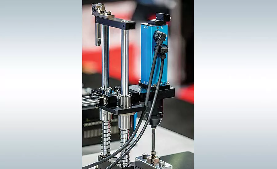

Robotic screwdriving works best with smaller screws and lower torques. Photo courtesy Mountz Inc.

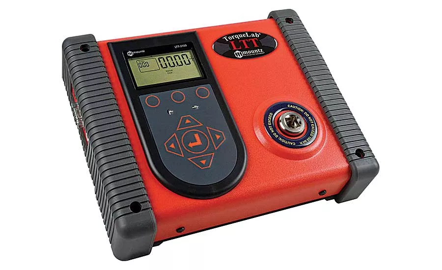

The TorqueLab LTT torque analyzer is designed for calibrating tools, joint testing, auditing and measuring torque. Photo courtesy Mountz Inc.

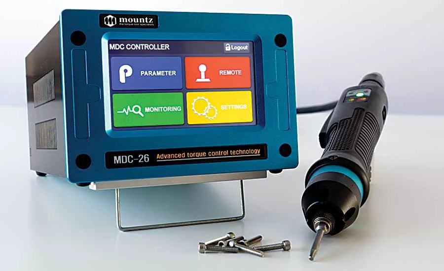

Several electric screwdrivers can be connected to this controller, which saves on programming time. Photo courtesy Mountz Inc.

Now, however, electric torque screwdrivers are available that are designed to work with, or that can be adapted to work with, robotic assemblers. If properly set up, these automation tools can free workers from the repetitive task of tightening fasteners. Because robots never forget a step, automation can significantly reduce errors and increase your product’s reliability. Just be sure automation is properly set up, that you choose the right tools and support them with auxiliary systems, and that you implement quality control processes and a strict calibration schedule.

A robotic electric torque screwdriver with a relatively low maximum torque limit is the ideal tool for automated assembly. Heavy-duty fastening applications that require a hundred or several hundred foot-pounds of torque are usually done by experienced workers equipped with pulse tools or other power tools. Only rarely can highly specialized machines be integrated into an assembly line for heavy-duty fastening. This is because of the initial difficulty of automating the assembly process, issues that happen when fastening is automated, and how these issues are magnified as size scales up.

Over time, even quality tools can slip out of specification and deliver outputs that are inconsistent with specifications. Due to the speed and volume of automated assembly processes, errors can propagate quickly—and expensively—throughout an assembly line. The longer you allow your tools to go between torque verification and torque calibration, the more likely it is that you will experience issues with fastening, leaving you to field calls from disappointed shareholders, outraged customers or curious legislators, depending on your industry.
Fortunately, there are multiple options for a torque calibration plan, and they can be scaled to your company’s size and output needs. Large manufacturers with high output levels will find it is worth their while to set up a torque calibration laboratory in-house. Many torque tool manufacturers also sell the equipment needed to calibrate those tools. Torque analyzers, torque sensors and run-down adapters fit right onto a benchtop in your plant and can be used to keep your manual and powered torque tools within specifications on a routine schedule. If a tool goes off of spec unexpectedly, you can prioritize its calibration and get it back on line quickly, without having to send it off to an outside service.
