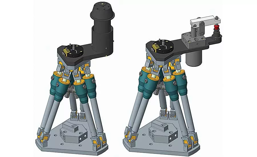

Our fixture is based on hexapods. A hexapod can move in all six degrees of freedom. Our hexapod is unpowered. It must be moved into position manually or by robot and then held in place with a locking sleeve or hydraulic system.
The hexapod has two plates connected by six links. The base plate is rigidly connected to the robotic cell. The top plate is equipped with a modular workpiece-locating assembly and the tool side of a robotic tool changer. The tool changer is what enables the robot to reposition the hexapod.
Each of the six links of the parallel mechanism is composed of two preloaded Cardan joints and a prismatic joint with an integrated hydromechanical brake. The Cardan joints connect the link to the top and base plate and are designed to minimize backlash. The prismatic joint is used to lock the mechanism in place once a suitable configuration has been achieved.
The workpiece-locating assembly is the part of the fixture that contacts the workpiece. Its design depends on the workpiece geometry and manufacturing operations. As a result, we could not design a truly universal locating system. Instead, we came up with a reconfigurable approach offering limited flexibility to accommodate a family of workpieces.
To assess the capability of our flexible fixture, we used it to assemble a family of automotive lights. The design of the workpiece-locating assembly was based on an analysis of the common geometric features of the whole product family. We determined that mounting holes were a suitable feature for locating and clamping the workpiece. However, different models have different hole diameters. To make the locating assembly compliant with the whole family of parts, the centering pins are interchangeable. To minimize human interaction and speed up the reconfiguration process, the pins are exchangeable by a robot. A pneumatic lever clamp holds the workpiece in place.
Preliminary testing revealed that additional support was needed during assembly. So, we designed a new locating assembly that used a centering element to supplement the clamping system. The centering element locates and supports the hole for the main bulb of the light. Different models have different diameter holes so the seating elements are exchangeable by robot as well.

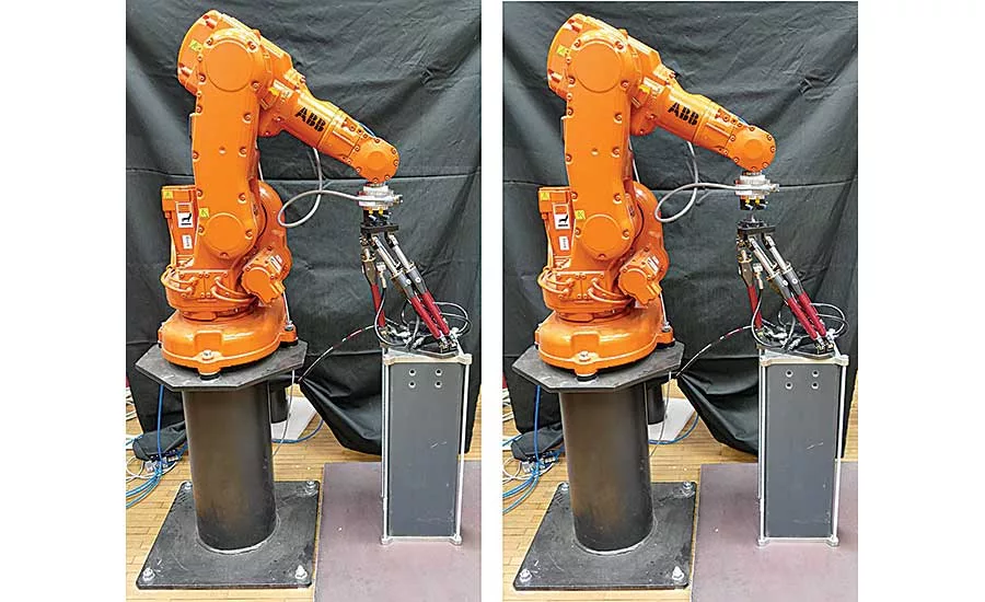

Our test setup was composed of a fixture with the baseplate attached to a stiff metal pillar secured to the floor. Our robot was an ABB IRB 140 equipped with a Delta force and torque sensor from ATI Industrial Automation and a QC-30 tool changer from DESTACO.

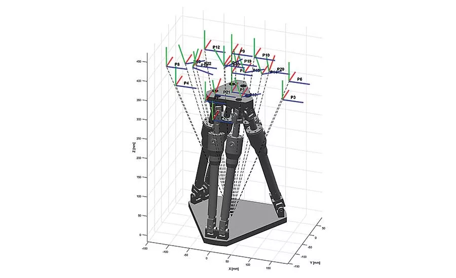

To facilitate positional measurements, no locating assembly was used. To measure the position of specific points on the hexapod, we used an Athos 3D optical measuring system from GOM. Accurate to ±0.04 millimeter, the system uses stereo triangulation
to obtain surface data in the form of a point cloud. For each measurement, three to five scans were made to get enough geometric data of the points on the top and bottom hexapod plate. From these measurements, three points on the hexapod’s top plate were extracted and their positions relative to the bottom plate were calculated. By measuring three different points on the hexapod’s platform, we were able to determine the positional and rotational displacements relative to the hexapod base.
Positional repeatability was measured in 20 configurations. The selected points were distributed equally inside the workspace envelope so we could measure the effect of the brake’s actuation on the final position of the hexapod. The robot was used to reposition the hexapod.
The reference position and orientation was measured twice. The first measurement was made while the hexapod was connected to the robot and still compliant. Afterwards, the mechanism was locked, the tool changer uncoupled, and the end-effector of the robot retracted. Then, the second position measurement was made to determine the position and orientation of the top plate. In this way, we were able to determine if the hexapod locking had any influence on positional accuracy.
Analysis of the data revealed that the mean positional displacement due to the position locking was 0.08 millimeter with standard deviation of 0.08 millimeter. The mean value of the rotational displacement was 0.9 milliradian and with standard deviation of 0.0005 milliradian.
Our tests showed that using the tool changer to connect the robot to the hexapod produced some negative effects. During uncoupling, the plates are pushed apart by approximately 1 millimeter. The force is considerable and caused visible movement of the robot. Fortunately, this problem could be solved by using an electromagnetic gripper.

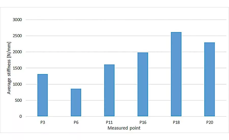

The stiffness of the hexapod was measured at six of the 20 points used for the repeatability measurements. The hexapod was locked, and the robot applied forces in six directions (positive and negative translation along all axes of the hexapod’s base coordinate system and positive and negative rotation along the Z axis). Forces were generated by pushing the fixture 0.3 millimeter in each direction while the mechanism was locked. The force magnitudes varied depending on the combined stiffness of the robot and the hexapod in a given configuration and direction. Forces and torques were measured using a sensor mounted to the robot’s wrist. A set of 3D measurements were made before and after the application of force in each direction to determine the magnitude and direction of displacements. The position and orientation of the top plate was measured relative to the hexapod bottom plate to avoid measuring deformation of other components, such as the pillars.
These measurements gave us an overview of the stiffness characteristics of the hexapod throughout its workspace. Stiffness was calculated taking into account only the components of forces and deformations collinear to the direction of the external load. The average stiffness across all the points in all directions was approximately 1,780 newtons per millimeter.
Different stiffness values were observed in different directions. Average stiffness in the X and Z directions was measured at 1,328.8 newtons per millimeter and 1,333.4 newtons per millimeter, respectively. The values are similar because of the symmetry of the mechanism. In the Z direction, the stiffness was considerably higher—2,323.4 newtons per millimeter. This is to be expected, as the angle between the hexapod legs and load in this direction is the smallest. More stiffness in Z direction is beneficial, since most assembly operations exert forces along this axis.

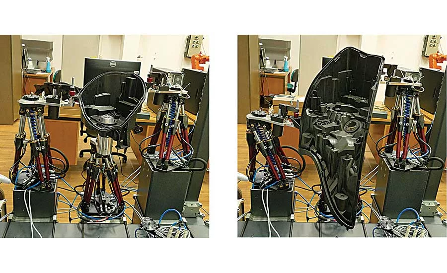

To test our fixture, we used it to assemble a variety of automotive lights.
Assembling a light is a multistep process. First, the plastic housing is manually inserted into a fixture in a semiautomatic machine. Next, an assembler installs various subcomponents, such as a light-height adjustment motor, a bulb holder, and a metal heat shield. Then, the components are secured with self-tapping screws driven by a servo screwdriver.
Typically, each light model requires two fixtures: one for the left light and one for the right. When a new light model is introduced, a new fixture must be designed and manufactured. This increases lead times and raises costs. Moreover, the fixture for the old part must be stored for 10 to 15 years so spare parts can be produced in small batches a few times a year. And, since automotive suppliers typically produce multiple models of lights at the same time, storing different fixtures becomes expensive.
Our goal was to develop a robotic assembly cell, equipped with flexible passive fixtures, that could assemble a family of lights with minimal changeover time and cost. Two different automotive lights were chosen for the first experiments. We chose these models because they have very different geometry but require similar assembly operations.
Three reconfigurable fixtures were used for work-holding. Two of them were equipped with pneumatic clamps, and one was equipped with a centering element.
Changeover between models is a three-step process. First, the three hexapods are repositioned to a predetermined model-specific configuration. Then, the centering pins of the clamps and the centering elements are removed and stored in special pallets using a dedicated robotic end-effector. Finally, new centering elements are installed.
The robotic reconfiguration was successfully tested multiple times. A UR10 robot from Universal Robots was used to move the hexapods. The exchange of modular elements was performed manually.
We also evaluated how the fixture would perform during assembly. The entire assembly sequence—inserting a part, installing subcomponents, and driving screws—was accomplished with the workpiece held in place by the reconfigurable fixtures. Several assembly cycles were successfully performed. The insertion of the light housing was reliable even when gripping was suboptimal. No accuracy issues were observed while installing the subcomponents. The forces exerted on the workpiece did not result in any observable fixture displacement.
Although testing is in a preliminary stage and further experiments are required, the reconfigurable fixtures show great potential to reduce the fixture costs and to shorten the changeover times.
