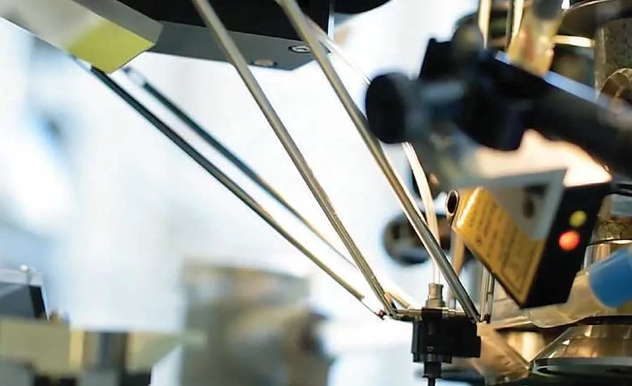

A delta robot feeds tiny watch parts into a burnishing machine. Photo courtesy RNA Automation

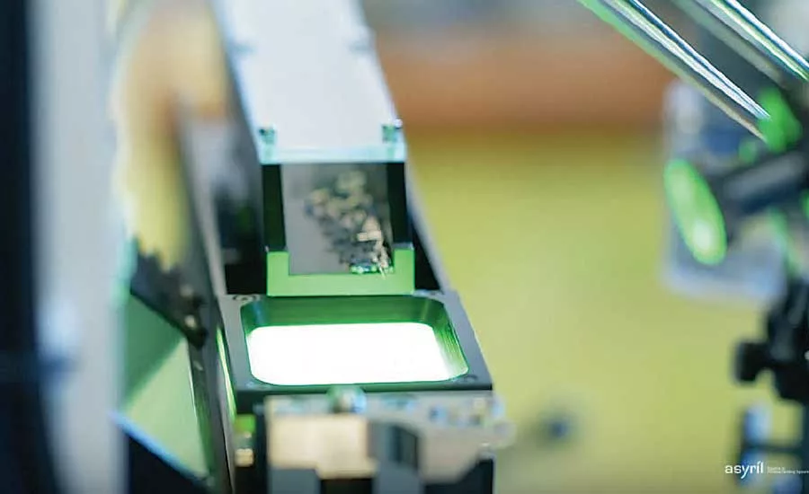

This small, vibratory tray orients delicate watch parts for pickup by a vision-guided robot. Photo courtesy RNA Automation

The system features a delta robot, a vision system and a flexible feeder. The parts to be burnished and polished are fed from a bulk supply into a vibratory hopper. Using three-axis vibration technology, the parts are quickly separated and oriented for pickup by the robot. The parts are illuminated from above and below, enabling the vision system to quickly identify correctly oriented parts and tell the robot where to find them. The robot picks and places the parts into a fixture inside a Strausak S70 polishing machine. Once the processing operation is finished, the robot removes the parts, and the cycle restarts.

The new system is also faster. With the delta robot, Affolter saves 1 to 2 seconds on loading time with every cycle.

The Asyfeed can handle parts from 0.1 to 5 millimeters in length. The system is gentle on parts and works consistently regardless of part geometry. Besides watch parts, typical applications include medical devices, jewelry, electronics and semiconductors.
