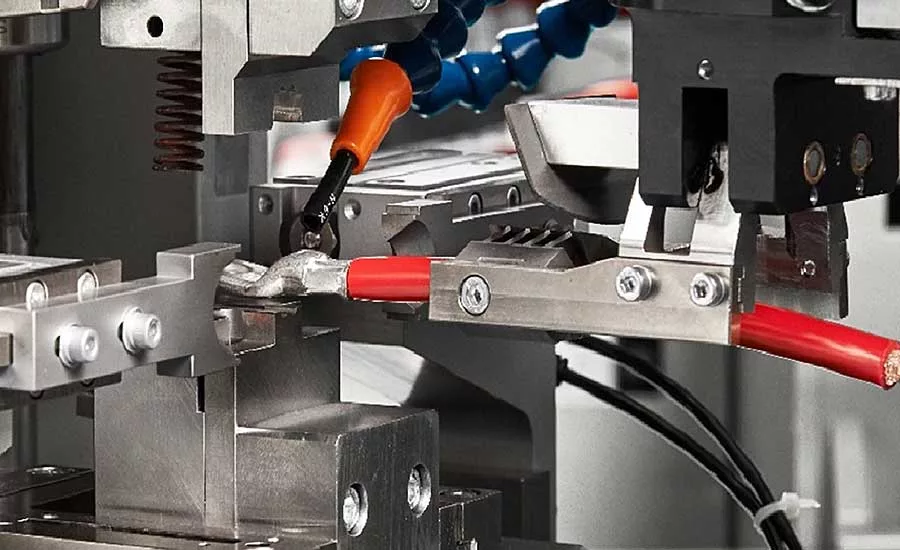

Heavy-duty pneumatic grippers on the CrX-44HD cleanly pull off insulation to strip large cable up to 000 AWG. PHOTO COURTESY ARTOS ENGINEERING CO.

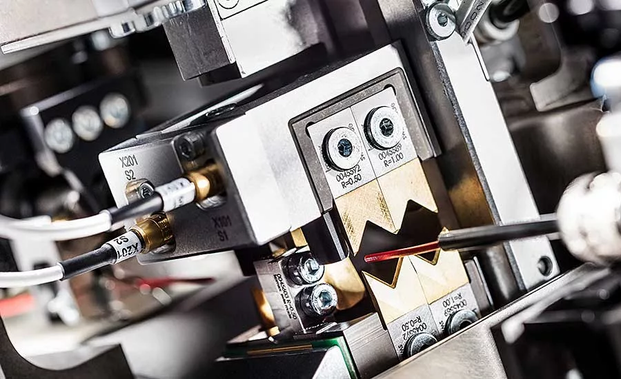

Automatic conductor detection technology detects the slightest contact between any standard blade and conductor strands during stripping. PHOTO COURTESY KOMAX CORP.

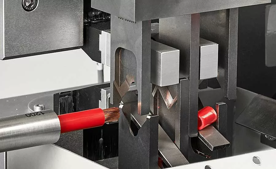

The CrX-44HD is capable of terminating open and closed barrels thanks to a largescale processor. PHOTO COURTESY ARTOS ENGINEERING CO.

Since 2018, makers of harnesses for many industries have used the Artos CrX-44HD machine to cut, strip and crimp copper and aluminum wire from 10 AWG up to 00 AWG, and cut and strip cable up to 000 AWG. The machine’s powerful processor features a heavy-duty feed drive, cutter head, wire straightener and pneumatic grippers. Maximum crimping force is 150 kilonewtons.
Joe Peterson, director of technical services at Artos, says the machine features robotics-based pick and place technology that properly positions loose-piece closed- and open-barrel terminals for termination. Another key feature is durable tooling, which enables fast changeovers of the terminal and die set, and lowers replacement costs due to extended wear life. Processing options on the machine are solder pots, heat shrink sleeve insertion and welding.

Another key feature is automatic conductor detection technology, which detects the slightest contact between any standard blade and conductor strands during stripping. Defective wire ends are immediately detected and rejected.
