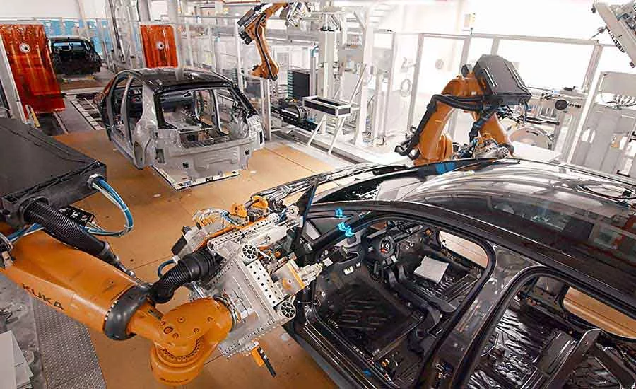

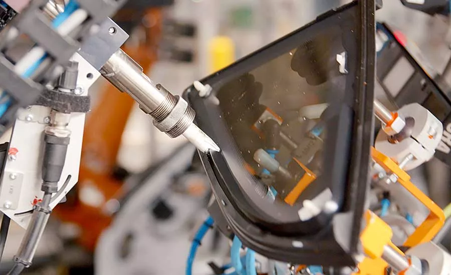

The window installation process is now performed entirely automatically, including the feeding of front and rear windows from sequenced containers and side windows from type-specific containers; adhesive application; and insertion of the front and rear windows in cycle operation and the side windows in flow operation. Previously, automated insertion of side windows was only possible in stop-and-go mode.
In cooperation with Volkswagen, Dürr developed a new line-tracking process that keeps the bodies moving on skillet platforms while robots install the side windows. This reduced costs, since the conveyor did not have to be adapted to cycle operation. The new line-tracking technology will enable automakers to integrate the side window bonding system anywhere on an assembly line.

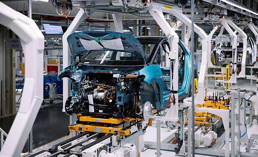

The pilot hall of the Zwickau factory has a 256-meter long section for overhead conveyors. In the past, 22 C-hangers with scissor lifts were used to transport car bodies on this line. However, these hangers were not compatible with the new undercarriage geometry of the electric vehicles, due to the high-voltage battery. Dürr replaced the C-hangers with four-arm hangers. Since bodies are no longer conveyed with wheels in the hanger, the project included a lifting platform for wheel assembly and the transfer operation.
