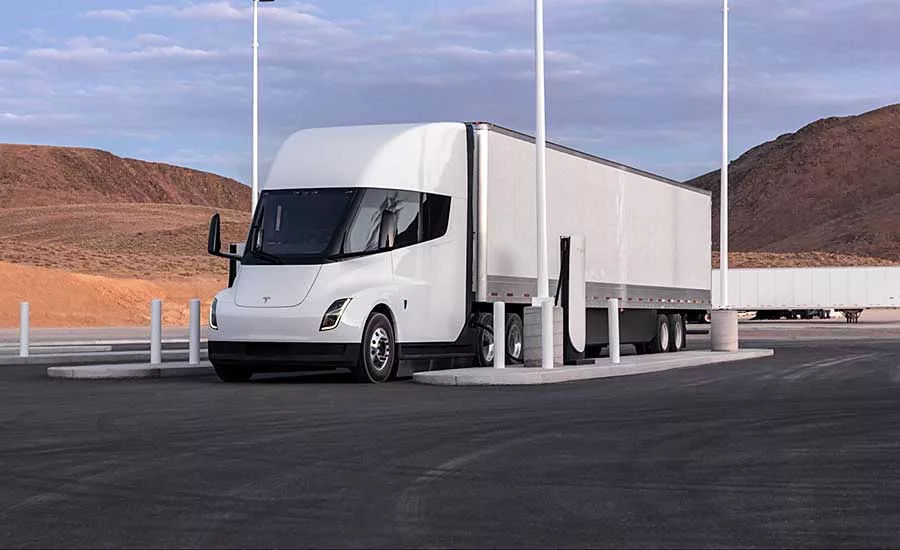

Tesla’s much-anticipated Semi truck has been delayed for several years. Illustration courtesy Tesla Inc.

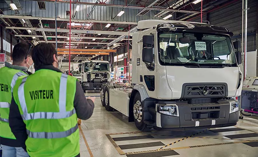

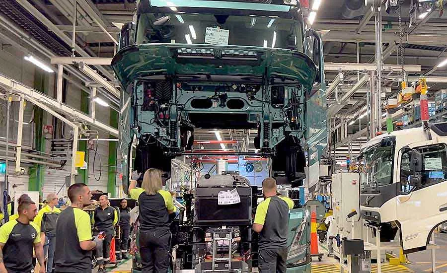

Half of all the electric trucks currently sold in Europe are produced at this factory in Blainville-sur-Orne, France. Photo courtesy Renault Trucks

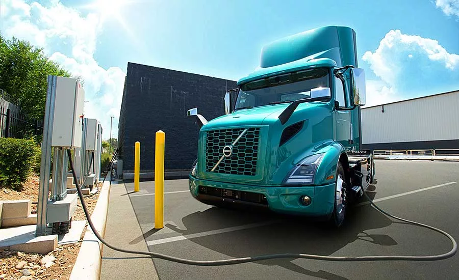

Volvo Trucks North America currently offers its VNR Electric in several configurations. The company is backing up its rolling product with plans to build out a charging network, starting first with a cross-California route.
With the Class 8 tractor, customers can choose either a four- or six-battery pack configuration. Class 7 trucks are only available with the former.
"We had a very strong base with our VNR model truck," says Andy Brown, product marketing manager for electromobility at Volvo Trucks North America. "Taking that truck platform, we were able to add the battery packs and the electric driveline."
Volvo Trucks also recently announced a new e-axle at the IAA Transportation trade show in Hanover, Germany. It will enable battery-electric vehicles (BEVs) to have an extended range by combining the driveline and transmission into one piece and carrying more batteries onboard.
"This will be a complement to our current electric drivelines with the existing trucks still being ideal for local and regional distribution," explains Brown. "We’re confident that with those options we can fit our customers' needs for any and all local delivery options."
Brown claims that heavy-duty electric trucks are an ideal way for companies to reduce their greenhouse gas emissions and move to a zero-tailpipe emissions transportation system.
"Currently, we’re focusing on customers who have local and regional routes for our BEV offering, as that’s currently the ideal range," adds Brown. "We expect that to grow as batteries and other technologies continue to advance.
"Our first phase of trucks had a range of around 150 miles and now we’re able to provide up to 275 miles of range with a six-battery configuration, and up-to a 230-mile range with the four-battery configuration," Brown points out.
While charging infrastructure is a work-in-progress in North America, Volvo Trucks is actively working with its partners to address the issue. Earlier this year, the truck manufacturer announced that it was constructing an electrified charging corridor for medium- and heavy-duty vehicles in California. It’s scheduled to come online by the end of 2023.
The plan is to build a string of charging stations running from Dixon, CA, north of San Francisco, to La Mirada in Los Angeles County. Volvo Trucks is partnering with Shell Recharge Solutions, TEC Equipment, Affinity Truck Center and Western Truck Center to develop the publicly accessible EV charging network, which is backed by a $2 million grant from the California Energy Commission.
"California has been an early adopter of electric trucks, but we see this as something that can be a road map of sorts to be done in other places across North America," says Brown, who predicts that demand will increase steadily in the near future.
"Simply said, there are companies that are aggressively pursuing sustainability goals like we are,” explains Brown. "Transportation companies also know that their customers are demanding lower and zero-emission alternatives. In fact, they fear losing business if they don’t start investing in zero-tailpipe emissions transportation."

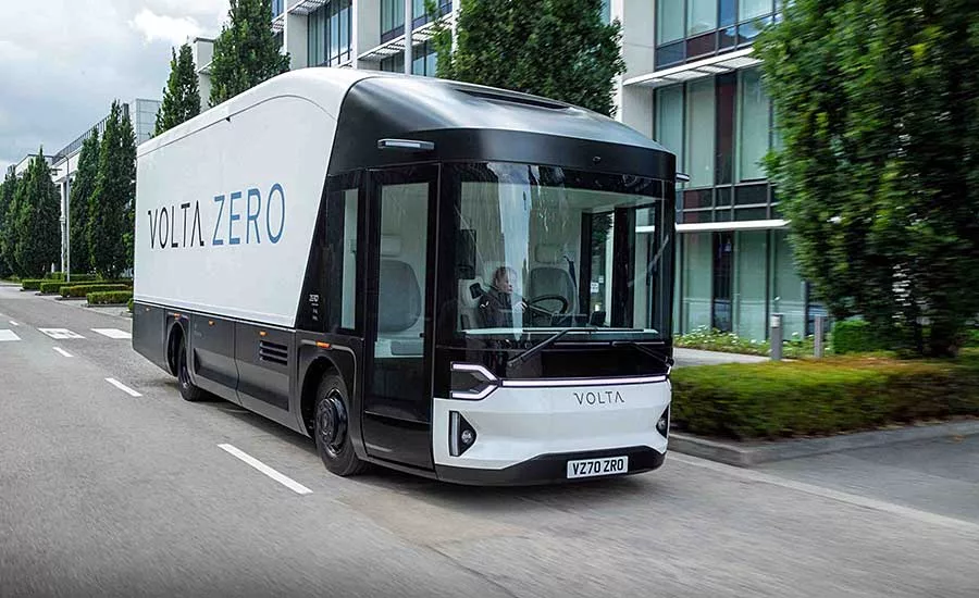

Volta Trucks Ltd. is a European startup that specializes in Class 5-7 medium-duty vehicles. The Class 7 Volta Zero features a unique center-mounted steering wheel and seat that enables drivers to enter or exit the delivery vehicle from either side.
The electric truck uses a modular battery pack supplied by Proterra that provides a range of 95 to 125 miles. A compact e-axle supplied by Meritor Inc. features an electric traction motor, transmission and axle in one unit.
Volta plans to start assembling vehicles in the U.S. by 2025. However, the first vehicles delivered to customers will be built at in Austria by contract manufacturer Magna Steyr.
The company will offer four versions of the Zero, including 7.5-, 12-, 16- and 18-ton variants, as well as a refrigerated version for temperature-sensitive cargo. The vehicle is designed for urban logistics and distribution applications.
Volta is using a truck-as-a-service strategy that bundles everything needed to transition to a full-electric fleet into one affordable monthly payment.
"We know that climate change and air quality problems are a reality that need addressing urgently and electrification is the answer," says Duncan Forrester, chief communications officer at Volta. "This is one of the main reasons why [we have] selected the urban distribution use-case at the outset.”

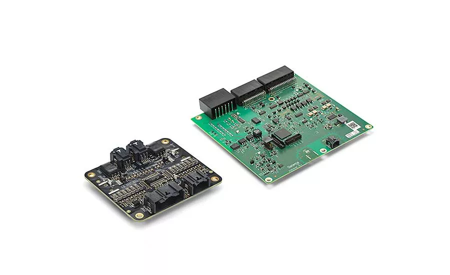

Battery management systems (BMS), the intelligent component that monitors and manages lithium-ion battery packs, could also help extend the range of electric commercial vehicles. It is the brain behind the battery and is critical to safety, performance, charge rates and longevity.
The BMS plays an important role in improving driving range, increasing battery lifetime and ensuring safe operation of the battery. These metrics are especially important for trucks, since they strongly influence vehicle uptime, which has a big impact on the profitability of operators.
To address the issue, Sensata Technologies Inc. has developed an ISO-26262 certified off-the-shelf BMS. The Lithium Balance n3-BMS reduces the time to market for battery pack manufacturers and OEMs.
"The software architecture has been separated into multiple layers, allowing customers to develop their own application software features without impacting the functional safety certification," says Ayoub Sidhom, product marketing manager for clean energy solutions at Sensata.
Even though customers can create their own application software features, Sensata engineers developed advanced algorithms and feature sets such as state of charge, state of health, state of power and balancing algorithms.

PHOTO B: Eaton Corp. displayed a variety of new products, including a power distribution unit for high-voltage vehicles that is designed to handle multiple load requirements. Flex PDU integrates Breaktor circuit protection technology, which improves vehicle safety and protects components from any level of overcurrent condition more effectively than traditional circuit protection methods. It also features sealed, corrosion-resistant terminals and connectors.
Flex PDU is an intelligent unit that provides diagnostic information, including where the most power is being consumed, to maximize performance and efficiency. Its integrated and optimized design reduces the number of components, lessening complexity.
