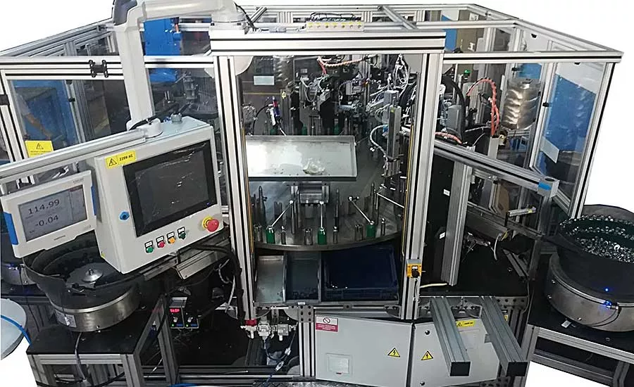

This assembly cell consists of a series of semiautomatic machines. Photo courtesy Genesis Automation Inc.

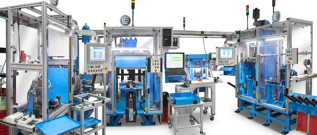

If a company needs to produce millions of assemblies annually, then a fully automated assembly system is the only way to go. Photo courtesy Edgewater Automation

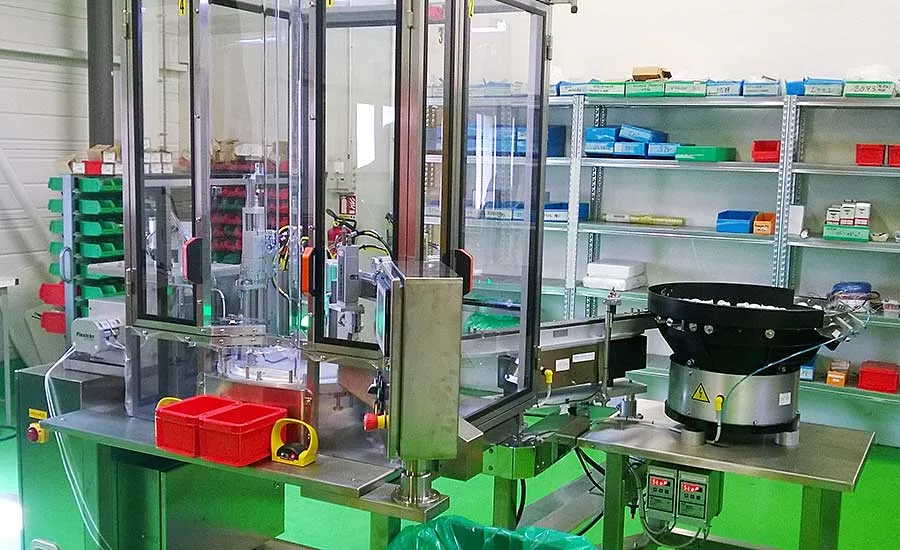

Products assembled on semiautomatic systems can benefit from some automation, but some aspects of the assembly are too difficult to fully automate reliably. Photo courtesy Koops Automation

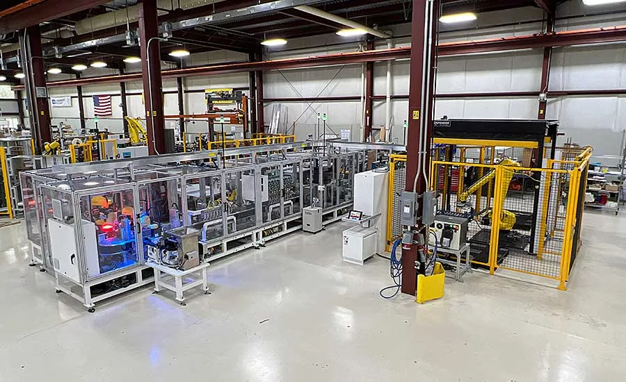

This automated assembly system blends manual and automated assembly processes. Photo courtesy ICM Automation

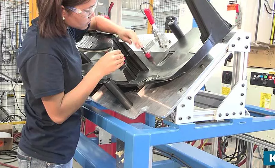

Many companies use manual assembly systems when their products don’t lend themselves to automation. This could be due to an intricate sequence in the assembly system, or a part that has a specialized function or shape. In these cases, manual assembly could be a manufacturer’s only option.

Semiautomatic systems are useful for companies that need to improve their manufacturing process, but aren’t able to completely get away from operator assistance. The products assembled on these systems can benefit from some automation, but some aspects of the assembly are too difficult to fully automate reliably. This can be because the incoming parts can’t be economically fed, or the volumes don’t justify a fully automatic system. Many companies go with this option to realize the significant process improvements while retaining the adaptability of an operator’s input.

Fully automatic assembly systems require no human interaction, except for loading bulk supplies of parts and clearing jams. Parts or subassemblies are loaded into feed systems or transferred from another system that will automatically load them into the next step of the assembly process. The automated system then completes the entire assembly, including testing, inspection and unloading.
If a company needs to produce millions of assemblies annually, then a fully automated assembly system is the only way to go. Indeed, many high-volume manufacturers have long experience running fully automated assembly systems, and they are looking to keep long-term costs low by not hiring more workers.
“At Edgewater, our view of a fully automated system is one that requires no operator interaction with the machine,” says Tate. “Parts would typically be automatically loaded onto conveyors, into a feed system, or even transferred directly from another process, such as a mold machine or a machining center. The system would then perform each assembly process automatically, including screwdriving, pressing, testing, vision inspection, unloading the product, and even final pack out. Systems such as this may still require human intervention to clear system faults, bad components or station jams.”

For example, Genesis recently designed and built a line with a mix of manual and automated processes. The line that assembled and tested an automotive component.
“Some of the parts being assembled were too large and oddly shaped to feed via traditional feeding methods,” recalls Gustafson. “The only fully automated solution would have been a vision-guided bin-pick robot and custom end-of-arm tooling for each component. Our customer’s budget did not allow for the additional cost of the complex automated part feeding stations. Therefore, manual load stations were implemented. The dexterity of human beings allowed for one operator to load multiple parts, which also reduced the total number of stations on the line.”
