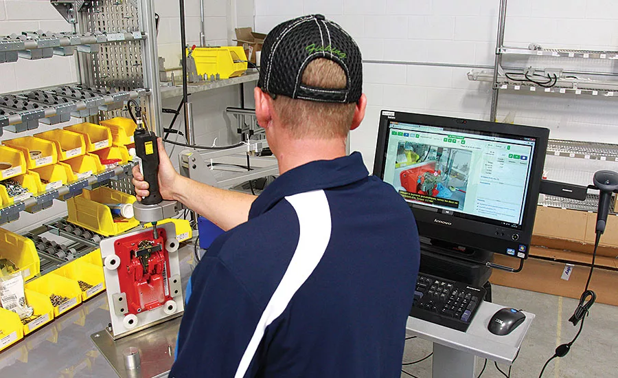

In this same vein, mistakes can often be prevented by re-examining the assembly entire line for sources of error. For example, in a modular workstation environment, a manufacturer can set up a progressive system in which each operator is responsible for adding just one component of the assembly. This helps with error-proofing, because each operator has only one task to do and can be trained to do it very well.
Similarly, by better organizing the workstations on a line, a manufacturer can reduce the chance that operators will make simple, but expensive mistakes. For example, a workstation's uprights can be equipped with clearly marked, color-coded part bins. Document holders can display assembly drawings or instructions. A manufacturer might even install a flat-screen computer monitor to display the different steps in an assembly process, making it easy for operators to access information via a touch-screen interface.
When installing threaded fasteners, engineers should take a good hard look at their product designs with an eye toward reducing the number and types of fasteners being used. In addition, setting up a line so that one operator is responsible for installing one type of fastener will reduce the possibility that an operator will install the wrong hardware.
