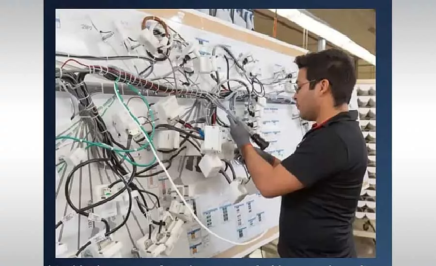

Made of plastic, these white blocks are holders that keep connectors in position during harness assembly. Photo courtesy HP Inc.
