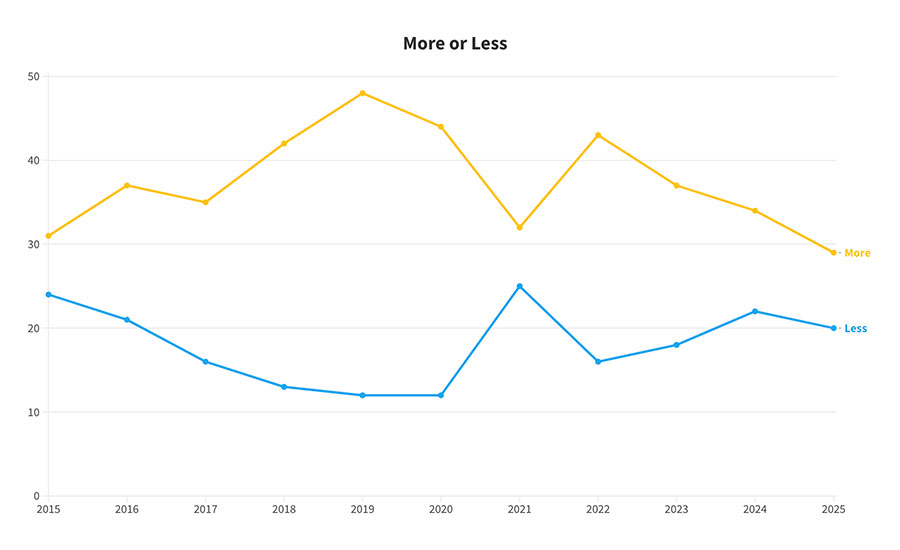

Spending to Increase
Just 29 percent of respondents will spend more on assembly technology next year than they did this year. That compares with 34 percent in last year’s survey, and it’s the lowest percentage since 2014. In fact, in the 29-year history of our survey, the “spend more” ratio has been less than 30 percent just three other times, two of which were the recession years of 2001 and 2009.
On a more positive note, 51 percent will spend the same in 2025 as they did in 2024. That compares with 44 percent in last year’s survey, and it’s the second highest percentage in survey history. In short, 80 percent of plants will spend no less next year than they did this year.
Twenty percent of respondents will spend less in 2025 than they did 2024, which is about average for our survey.

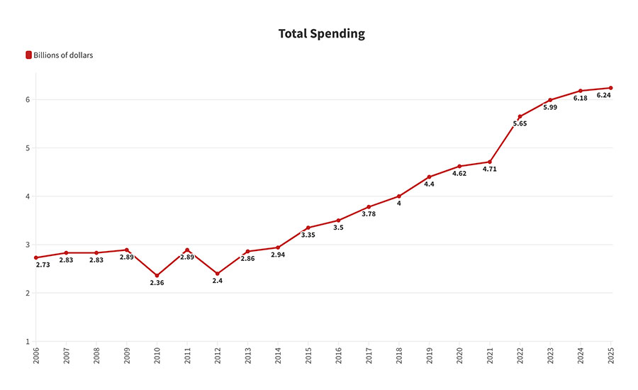

Total Capital Spending
U.S. assembly plants will spend $6.24 billion on new equipment in 2025, an increase of 1 percent from 2024 spending.
Of those plants that will spend more, the average budget increase is 23 percent. Of those that plan to spend less, the average budget decrease is 23 percent.
Overall spending will not increase that much, however. Our data indicate that U.S. assembly plants will spend $6.24 billion on new equipment in 2025, an increase of 1 percent from the $6.18 billion projected to be spent in 2024.
On average, manufacturers will spend $1,194,297 on assembly technology in 2025. That compares with $1,970,582 in 2024, and it’s marks the fourth straight year that the average budget has topped $1 million. The median budget total is $250,000, which is significantly more than the $200,000 figure in 2024. In fact, it’s the largest median budget in survey history.

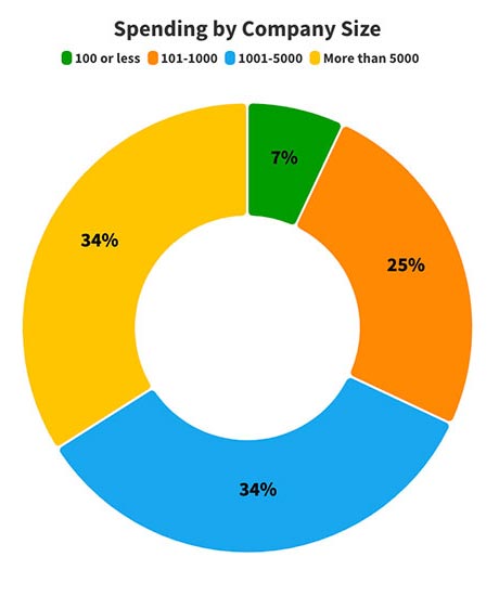

Capital Spending by Company size
Companies with at least 1,000 employees will account for 68 percent of total spending in 2025.

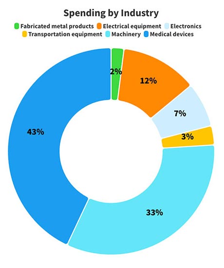

Capital Spending by Industry
Medical device manufacturers will account for 43 percent of total spending next year. It’s the first time in survey history that the industry will account for the lion’s share of capital spending.

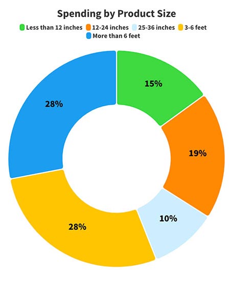

Capital Spending by Product Size
Any increase in spending next year will be driven by manufacturers of large products. Assemblers of products larger than 3-foot cube will account for 56 percent of total spending next year, the most since 2016.

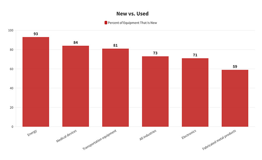

New vs. Used Equipment
Some industries are more willing to deploy used or rebuilt equipment than others. Not surprisingly, 93 percent of the equipment purchased by manufacturers of batteries, solar panels and other alternative energy products is new. Conversely, only 59 percent of the equipment purchased by manufacturers of hinges, leaf springs and other fabricated metal products is new.
Compared with other industries, medical device manufacturers are less concerned about reducing costs (38 percent vs. 53 percent for all U.S. plants) and replacing old or worn-out equipment (13 percent vs. 48 percent for all U.S. plants). But, they are more concerned about assembling new products (50 percent vs. 34 percent for all U.S. plants) and increasing capacity (63 percent vs. 53 percent for all U.S. plants).
As for cost targets, medical device manufacturers are more concerned about the cost of materials (50 percent vs. 36 percent for all U.S. plants) and scrap (75 percent vs. 46 percent for all U.S. plants) than other industries. They are less concerned about the cost of indirect labor (38 percent vs. 48 percent for all U.S. plants) and in-process inventory (13 percent vs. 23 percent for all U.S. plants), which makes sense since many medical device companies are low-mix, high-volume manufacturers.
Given the nature of their products, medical device manufacturers are not too keen on used or rebuilt equipment. On average, 84 percent of device manufacturers’ budgets will be spent on new equipment. That compares with 73 percent for U.S. plants.

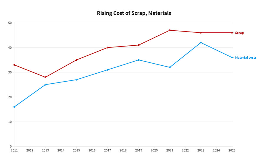

Rising Cost of Scrap, Materials
Manufacturers today are employing sophisticated materials in their products, including high-strength steel, aircraft-grade aluminum, composites and engineering plastics. Small wonder, then, that assemblers are increasingly concerned about the cost of scrap and materials.

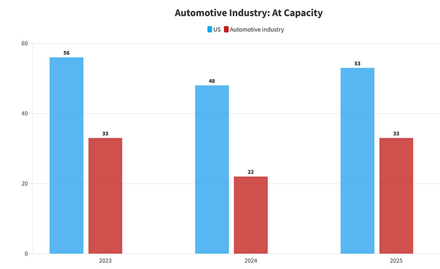

Automotive Industry: At Capacity
The automotive industry doesn’t need to add capacity. Only 33 percent of plants will buy equipment next year to increase capacity. That compares with 53 percent for the nation as a whole, and it’s the lowest percentage of any industry. In fact, the industry has held that distinction in four of the past five surveys.
Certainly, the industry doesn’t need to add capacity. Only 33 percent of plants will buy equipment next year to increase capacity. That compares with 53 percent for the nation as a whole, and it’s the lowest percentage of any industry. In fact, the automotive industry has held that distinction in four of the past five surveys.
Given the industry’s transition to EVs, it’s no surprise that 53 percent of plants will be purchasing equipment to assemble something new. That compares with 34 percent for all US plants, and it marks the second straight year in which that ratio has topped 50 percent.
Last year’s deal with the UAW might be reflected in the costs automotive assemblers are targeting for investment. Eighty percent are looking to reduce the cost of direct labor. That compares with 70 percent for the nation as a whole.

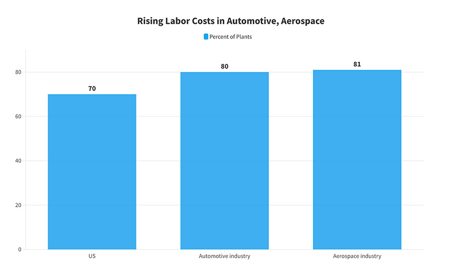

Rising Labor Costs in Automotive, Aerospace
Given the recent strikes in the automotive and aerospace industries, labor costs are a growing concern. For example, 80 percent of plants in the auto industry are looking to reduce the cost of direct labor. That compares with 70 percent for the nation as a whole.

Capital Spending Comparison - 2024 vs. 2025

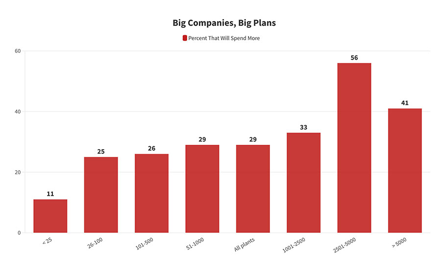

Largest Companies Drive Investment
Looking at spending by company size, our data indicate that our largest manufacturers will once again dominate capital spending.
For example, 56 percent of companies with 2,501 to 5,000 employees and 41 percent of companies with more than 5,000 employees will spend more next year than they did this year. Conversely, only 25 percent of companies with 26 to 100 employees and 11 percent of companies with 25 employees or less will spend more.
All totaled, companies with at least 1,000 employees will account for 68 percent of total spending in 2025.
Large Companies More Likely to Increase Capital Spending
Large companies will be more likely to increase spending next year than small ones. For example, 41 percent of companies with more than 5,000 employees will spend more in 2025 than they did in 2024. Conversely, only 11 percent of companies with 25 employees or less will spend more.

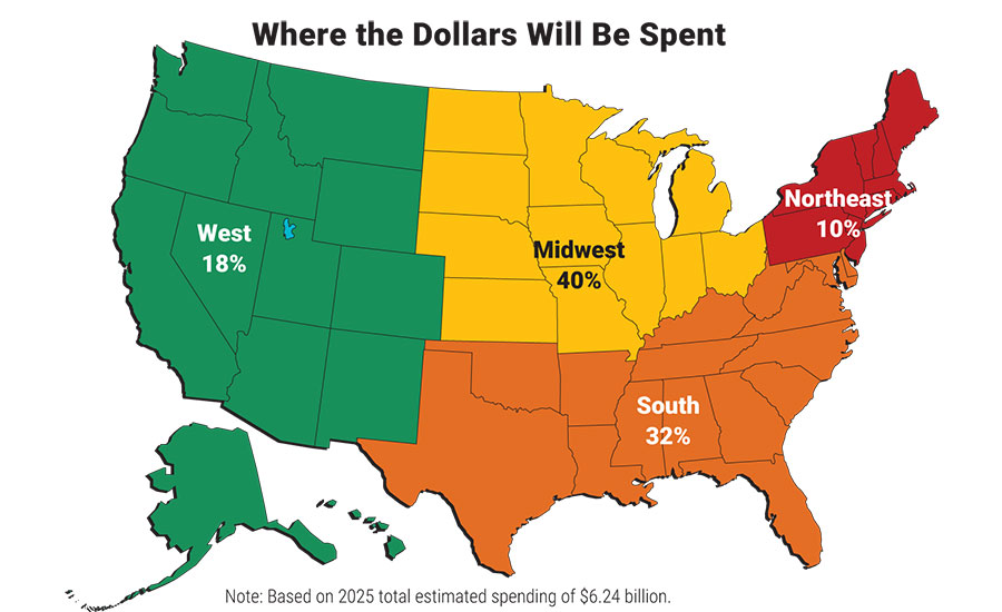

Spending by Region
The Midwest has traditionally been the epicenter of U.S. manufacturing, and next year will be no exception. The region will account for 40 percent of spending in 2025, more than any other part of the country. In fact, the Midwest has held the lion’s share of spending for all but two years in our survey, and the region has accounted for at least 40 percent of total spending for 10 of the past 26 years.
On average, Midwestern manufacturers will spend $1,130,262 on assembly technology in 2025, the fourth straight year in which the average budget has topped the million-dollar mark.
Where Capital Investment Dollars Will Be Spent
The Midwest will account for more spending in 2025 than any other region. The Midwest has held that distinction for all but two years in our survey.

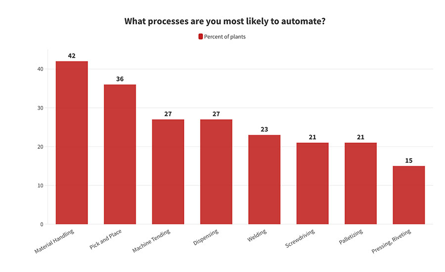

What Processes are Manufacturing Plants Most Likely to Automate?
When asked which processes they are most likely to automate in the coming year, assemblers overwhelmingly picked material handling.

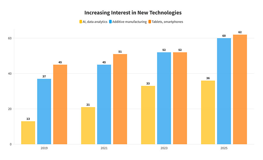

Increasing Interest in New Technologies
Manufacturers are increasingly adopting new technologies on the assembly line. Since 2019, the number of plants implanting AI, additive manufacturing, and tablet computers has steadily increased.

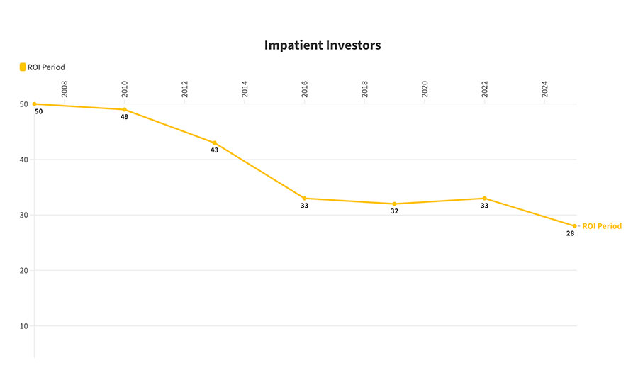

ROI Expectations
Manufacturers increasingly expect a quick return on capital investments. Since 2007, the percentage of plants with an ROI period of two years or more has steadily decreased.
