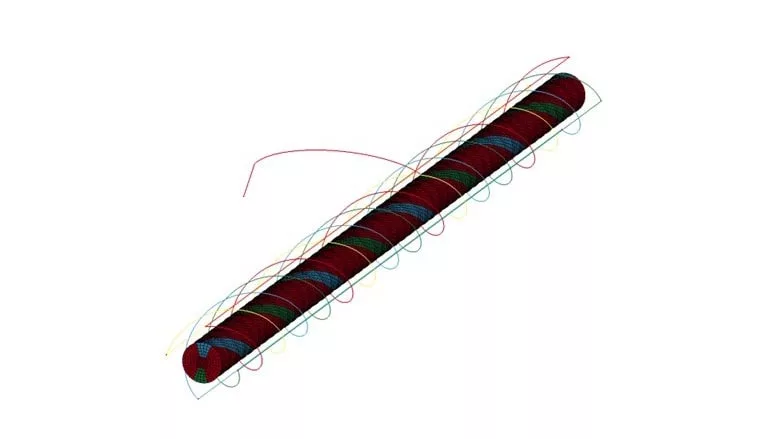

I started this project with a candy cane plan—a sweet little profile to fit in my hand. A cylinder came next, with a mesh oh so fine, to twist into something quite festive, divine.
Some profiles I made to help with the task, for morphing the mesh—it’s easy, just ask!
The stripes now appear in a classic design. They twist and they shimmer, a sight so fine.
With morphing complete, the mesh is just right. This candy cane’s ready—it’s quite the delight!
