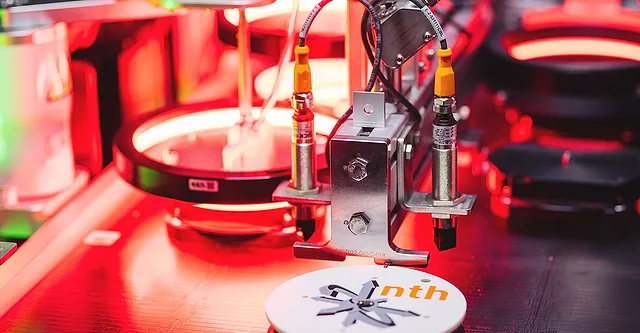

In the finalized assembly machine, operators manually feed in specific devices via a drawer, as specified by the customer. Then a robot places the device on one of 18 independently controlled XPlanar movers. Custom tooling locks the device in place on the mover. Then the device undergoes a vision inspection using 360-degree rotation.
The movers fly the devices through a variety of dispense stations lining the 18-motor-tile work surface. The hovering movers stop only at the dispense stations specified in each device’s recipe, with a second vision test halfway through. The XPlanar mover rotates the device so the reagent is placed in the correct location for that formulation.

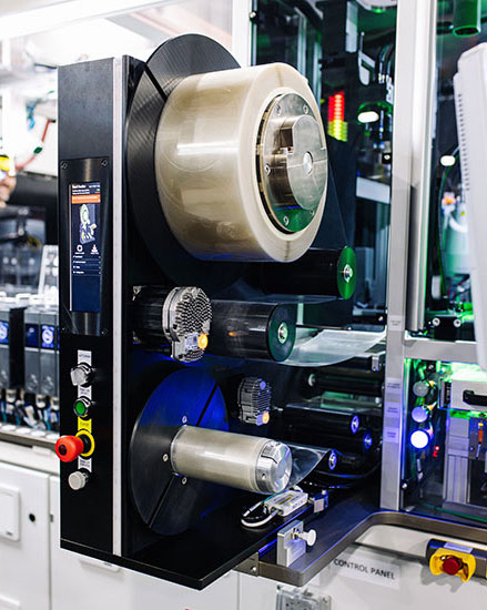

Unhappy with other labeling and capping equipment, Automation NTH decided to make its own modular device using EtherCAT communication and a C6017 ultra-compact industrial PC from Beckhoff. Photo courtesy Beckhoff Automation
After a final vision inspection, the reel feeder seals the device with an adhesive plastic cap with ±30 micron repeatability. The XPlanar mover then delivers the finished product to an operator station. The mover slides the release hook into a groove, edges forward to release the device, and then parks with power off on the tile below so that it no longer levitates. An operator can then reach in through the light curtain to remove the finished device.

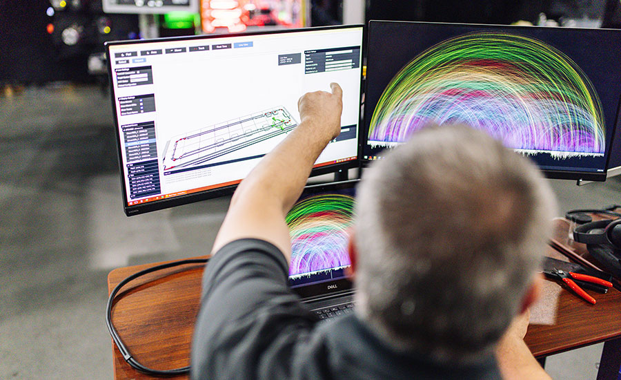

TwinCAT provided an end-to-end engineering and run-time platform for the machine. Integrated into Microsoft Visual Studio, TwinCAT empowers engineers to program in the languages that best fit the application, including standard PLC programming languages according to IEC 61131-3 with object-oriented extensions, prebuilt and custom function blocks, and computer science languages like C++ and Python.
“With TwinCAT, you’re completely in charge of how you program,” Cocchini says. “It’s very powerful, and there are essentially no limitations.”
TwinCAT includes a graphical configurator for XPlanar that helps with creating motor tile layouts, adding movers via simple drag-and-drop, defining paths and stations, and simulating motion profiles. It empowers engineers to customize movements granularly.
“Our customer has a disc with several XY CAD coordinates that change constantly. We just input those numbers into our system and watch the XPlanar work,” Cocchini says.

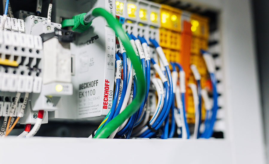

Automation NTH uses a variety of EtherCAT and TwinSAFE I/O terminals on the assembly machine and reel feeder. Photo courtesy Beckhoff Automation
The EtherCAT industrial Ethernet system is crucial for accelerating the motion control on the XPlanar via real-time communication and high synchronization. The machine also uses EtherNet/IP for control of various cameras, dispense heads and other devices. The simple addition of an EtherNet/IP coupler in the main I/O segment or a dedicated RJ45 port on the Beckhoff industrial PCs simplifies integration of EtherNet/IP or other protocols as needed.
The C6670 and C6017 machine controllers also communicate via EtherCAT Automation Protocol. This allows them to coordinate motion control and pass safety data via Safety over EtherCAT. TwinSAFE terminals installed in the standard I/O segment provide the necessary safety logic. So, if an e-stop or light curtain is triggered on the filling side, the reel feeder module will also enter a safe state without any hard-wiring.
Along with numerous EtherCAT terminals for standard I/O, the equipment leverages a wide range of I/O hardware from Beckhoff for overcurrent protection and other functionality. EL2564 four-channel LED output terminals power indicator lights on both the machine cell and reel feeder.
