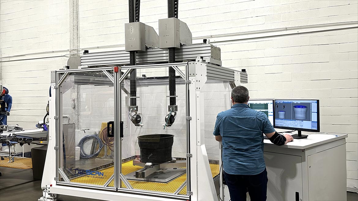

By integrating advanced tools at every stage of the UT inspection process (scanner control, inspection planning, and results interpretation), automated NDT systems can deliver the precision, efficiency, and reliability required for modern aerospace manufacturing.
Figure 1. Gantry system with 3D and contour following scanning capabilities
Figure 1. Gantry system with 3D and contour following scanning capabilities Image Source: TecScan
Scanner Control Tools
Ultrasonic testing of aerospace components with complex 3D geometries requires advanced control tools to achieve precise and comprehensive scanner control. For example, UT immersion tanks and squirter gantry systems integrate contour-following capabilities and multi-axis motion control to ensure accurate UT inspection coverage. These systems can also be equipped with 3D Scanning capabilities using advanced path-planning algorithms to adapt to intricate surface profiles, enabling full volumetric inspection. Additional scanner control capabilities and tools are also required to monitor and maintain the ultrasonic probes alignment to achieve proper scanning resolutions.

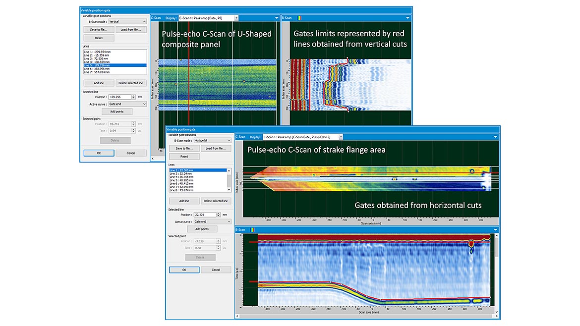

Variable signal gating is another essential tool, particularly when variations in component thickness prevents from using simple gates to detect indications without interferences from the back wall echo. With position-dependent gating, the detection gate dynamically adjusts based on the B-Scan representation, following the component thickness.
Figure 4. Examples of variable inspection gating using TecView for composite U-Shape and Strake parts
Figure 4. Examples of variable inspection gating using TecView for composite U-Shape and Strake parts Image Source: TecScan

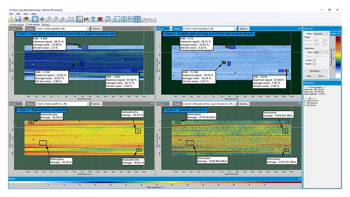

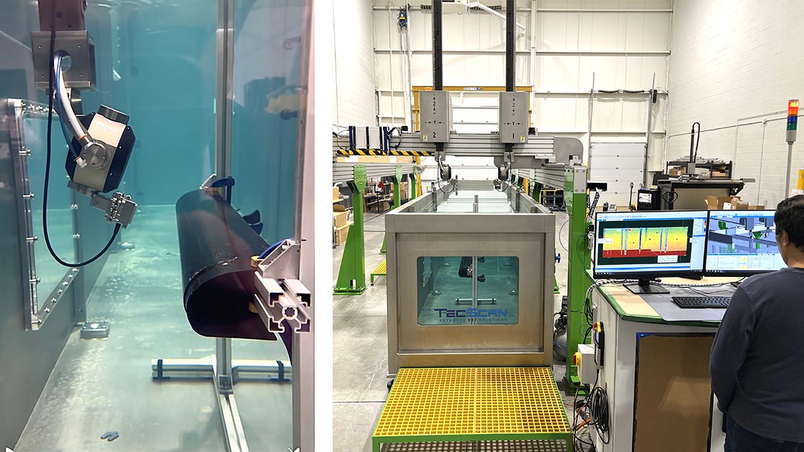

This example highlights advanced motion control and data interpretation functionalities necessary to fulfill inspection requirements. The U-shaped carbon composite part features areas of different thicknesses. Despite its simple appearance, 3D contour following scanning is required to maintain a constant beam entry angle and water path. Variable gating is also necessary to avoid setting up a specific gate for each thickness variation.
Figure 5. Automated immersion system used for the inspection of U-Shaped carbon composite panel
Figure 5. Automated immersion system used for the inspection of U-Shaped carbon composite panel Image Source: TecScan
Since porosity is often monitored in carbon composite laminates, backwall echoes attenuation must be analyzed. This can be done by evaluating the acceptable dB drop for each thickness range or calculating the attenuation per units of thickness.
Figure 6. Different C-Scan representations resulting from the inspection of the U-Shaped carbon composite panel. C-Scan 1 (top-left) and C-Scan 2 (top-right) illustrate the benefit of using variable gate
Figure 6. Different C-Scan representations resulting from the inspection of the U-Shaped carbon composite panel. C-Scan 1 (top-left) and C-Scan 2 (top-right) illustrate the benefit of using variable gate Image Source: TecScan
In the above example of Fig. 6, the benefits of variable gating (C-Scan 2, top-right) for the detection of internal indications is illustrated by comparison to a fixed gate (C-Scan 1, top-left). Porosity characterization can also benefit from a conversion of backwall amplitude (C-Scan 3, bottom-left) to attenuation data (C-Scan 4, bottom-right). While direct backwall amplitude must be compared to the expected signal amplitude or drop corresponding to the thickness of a specific area, attenuation provides a reading that is independent from thickness. This is beautifully illustrated in this example, where large variations observed on the backwall amplitude are not relevant when converted to attenuation, especially for the lowest monitored backwall amplitude which converts to the lowest attenuation.

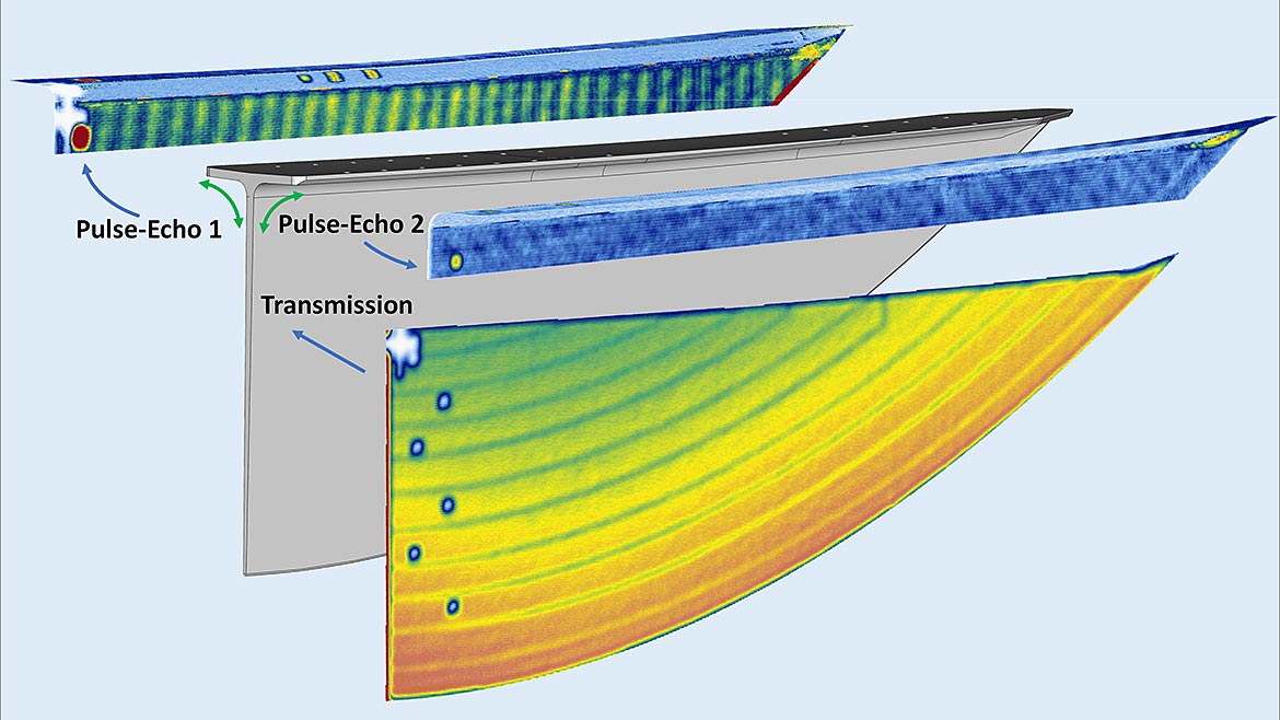

Aircraft engine chines and strakes represent a slightly more complex form of composite panels. With their T-shape, multiple setups are required to scan the entire part. In the example below, the fin of a strake was scanned in a through-transmission setup, while both sides of the flange are scanned in pulse-echo. These scans were done using a 10-axis scanner with two independent sets of X-Y-Z-A-B axes.
One of the tools that can minimize scan time is a batch scan utility, i.e. the ability to execute multiple scan setups automatically without requiring any operator intervention. Pulse-echo and through-transmission scans were therefore performed in a programmed sequence, as illustrated in Fig. 10. In addition, these structures have varying thickness that require variable gating for pulse-echo scan data interpretation.
Figure 10. 3D representation of Pulse-Echo and Transmission scans in an engine strake obtained by running a sequence of inspection setups
Figure 10. 3D representation of Pulse-Echo and Transmission scans in an engine strake obtained by running a sequence of inspection setups Image Source: TecScan

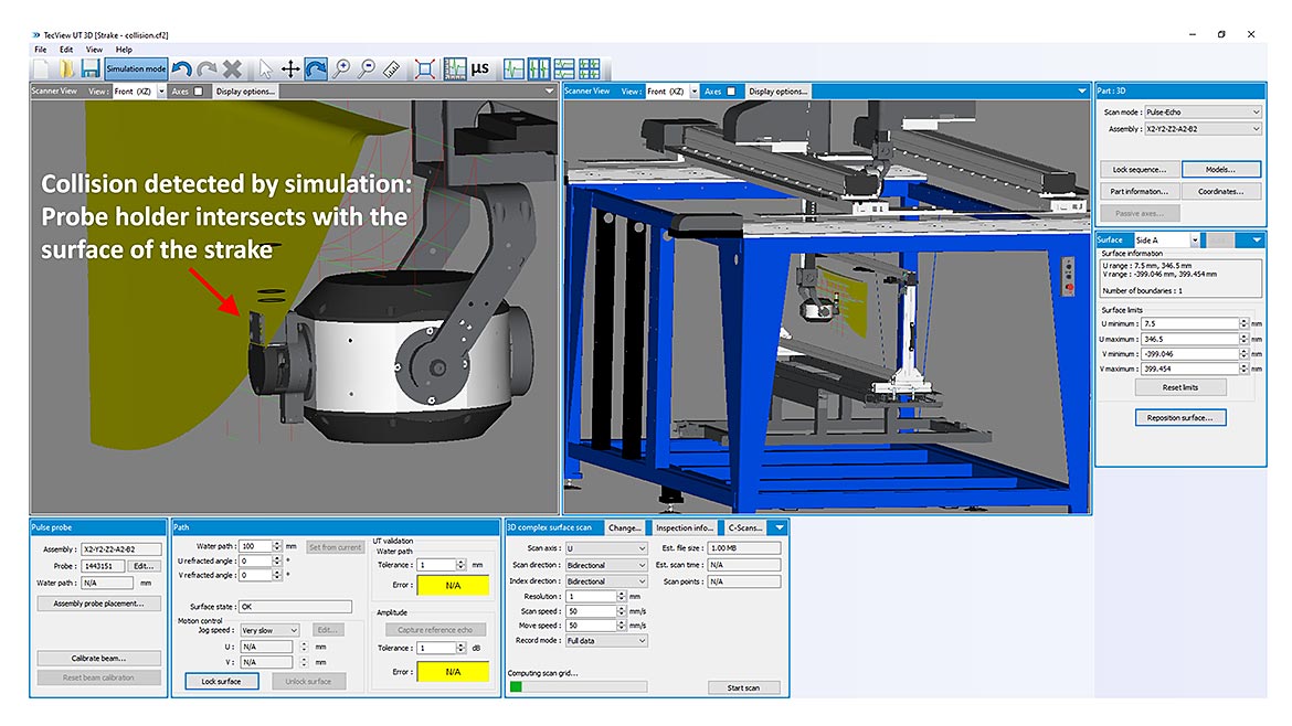

Another particularity of the strakes and chines is the tight radius of the transition between the fin and the flange. Scanning surfaces at and around the flange radius therefore presents high risks of interference between the probe gimbal manipulator and the part.
Figure 11. Example of identification of collision in TecView 3D display environment from the intersection of the scanner model with the inspected part model
Figure 11. Example of identification of collision in TecView 3D display environment from the intersection of the scanner model with the inspected part model Image Source: TecScan

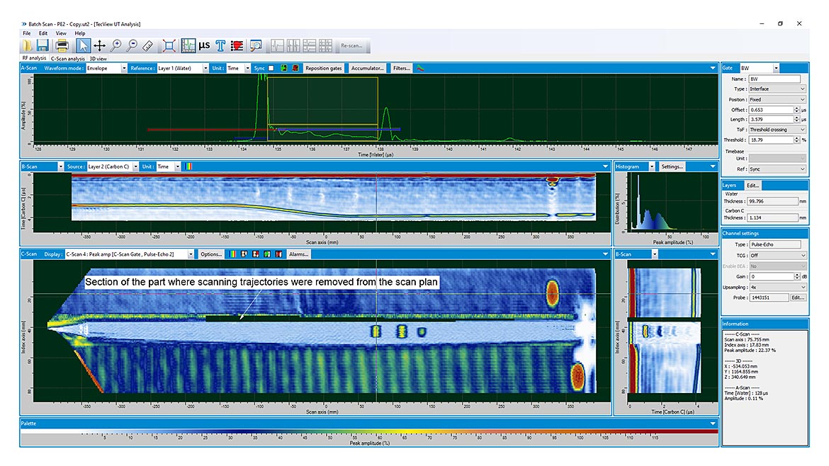

This is where accurate simulation tools become essential in the preparation of the scan setup. Collisions can be identified by simulating the movement of the probe around the radius at the required water column and angle and trajectories can be modified to avoid such interferences. This exercise leads to an optimization of the scanning time by maximizing areas of the part that can be scanned automatically, while identifying areas where a complementary manual inspection may be necessary. In the example below, a section of surface identified by simulation and leading to collisions has been removed from the scanning area, thus avoiding the problematic trajectories.
Fig. 12. Display of the inspection area after removal of the scanning positions responsible for mechanical interference illustrated in Fig. 10.
Fig. 12. Display of the inspection area after removal of the scanning positions responsible for mechanical interference illustrated in Fig. 10. Image Source: TecScan
Figure 13. Pulse-Echo C-Scan resulting from the inspection of the strake sample after removal of the problematic scanning positions.
Figure 13. Pulse-Echo C-Scan resulting from the inspection of the strake sample after removal of the problematic scanning positions. Image Source: TecScan
