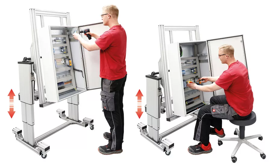

MINDEN, Germany—The new RK Easymount mobile worktable from Rose + Krieger makes assembly of control cabinets easier, more efficient and more ergonomic. The table provides assemblers with a convenient work surface on which to keep tools and materials close at hand.
To suit the needs of each assembler and project, the work surface can be raised or lowered by 650 millimeters, and it can be tilted from 0 to 90 degrees. Adjustability is provided by electric actuators powered by commercially available, rechargeable batteries.
Cabinets can be quickly mounted to the table using slot nuts. Customer-supplied accessories can be attached along a continuous profile groove.
Stable and resilient, the table is suitable for loads of up to 674 pounds. (Designs for higher loads are available on request.) The table can be equipped with leveling feet or lifting, swiveling or fixed casters.
