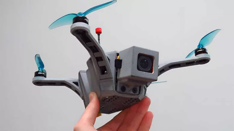

3D-printed drone camera housing
This drone camera housing was printed. Photo courtesy Stratasys
