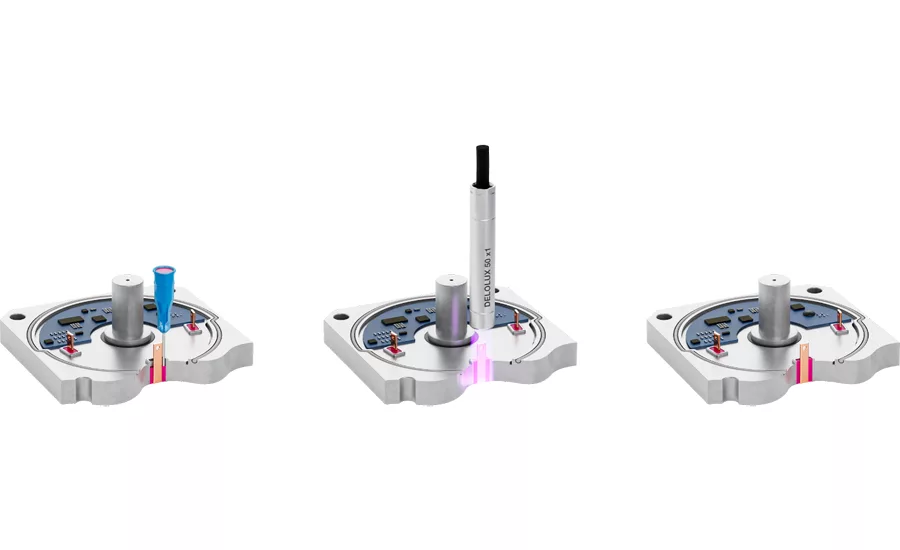

Illustration showing an automated adhesive dispensing process on an electronic assembly, including material application, UV inspection, and completed sealant placement.
Source: DELO Industrial Adhesives
These illustrations show the dual-curing process. First, the sealant is dispensed (left). Then, it is instantly fixed with exposure to UV light (center). Final curing in shadowed areas occurs at room temperature with exposure to ambient moisture.

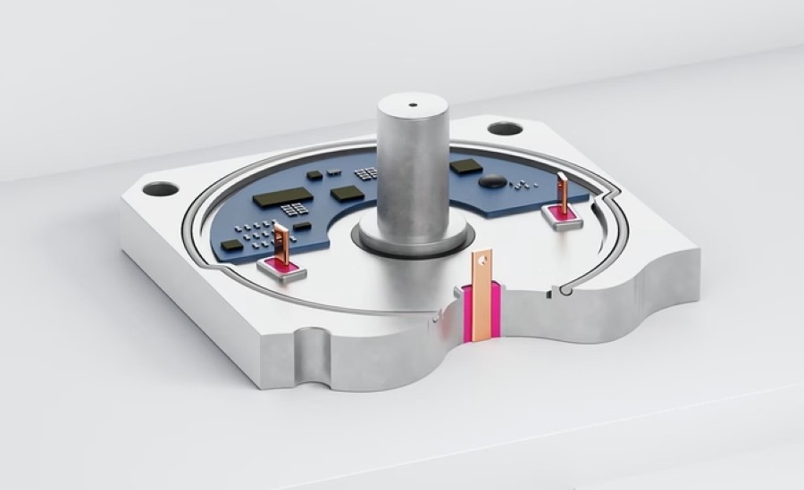

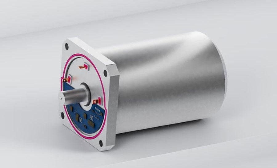

A particularly critical area is the transition between electronics and mechanical assemblies. Electrical pins and busbars typically connect internal electronic assemblies to the outside of a component, such as an oil pump or compressor. Sealants protect pins and busbars from chemicals and moisture. These parts must be protected even under extreme temperature stress. Even the smallest delaminations or cracks in the sealant can lead to corrosion or even short circuits.
Cross-sectional illustration of an electric vehicle motor assembly showing magenta sealant applied around electrical pins and busbars to protect internal electronics from moisture, oil, coolant, and temperature-related stress. Cross-sectional view of an electric vehicle power electronics assembly showing magenta sealant surrounding electrical pins and a busbar as it passes through a metal housing, creating a barrier against moisture, coolant, oil, and thermal stress.
Sealing the pins on an oil pump is crucial to protect its internal electronics. In this illustration, the sealant is colored magenta to indicate its location. Source: DELO Industrial Adhesives

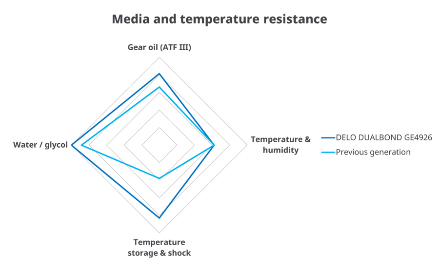

One of the newest is Dualbond GE4926. Compared with the previous formula, the swelling behavior of Dualbond GE4926 after long-term storage in automatic transmission fluid at 160 C has been reduced by 85 percent. Various oil and temperature storage tests show that the sealant exhibits more than twice the adhesion on common substrates as the previous formula.Radar chart comparing adhesive resistance to gear oil, water and glycol, temperature and humidity, and thermal shock between two adhesive formulations.
This spider diagram shows how the properties of Delo Dualbond GE4926 compare with previous formulations—particularly under temperature influence. Source: DELO Industrial Adhesives
The elongation at break—an important mechanical characteristic for evaluating permanent elasticity—has also been optimized: The decrease after long-term storage in various harsh media is about 20 percent lower. Maximum operating temperature is now 160 C.

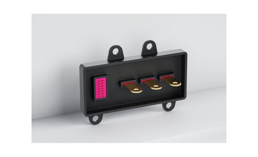

Sealing performance is determined not only by the material, but by the geometry of the pins and cavities. Undercuts, uneven gap widths or insufficient wetting surfaces can significantly impair sealing effectiveness. A coordinated interaction of material, dispensing strategy, flow behavior and curing process is crucial. This concept applies equally to busbars, due to their flat and sometimes multi-layer conductor structures.
3D rendering of a sealed electrical connector assembly featuring power terminals, signal contacts, and gasket sealing for automotive and industrial applications.
For busbars, it’s essential for the sealant to flow into the smallest gaps and cover the entire component. In this illustration, the sealant is colored magenta to indicate its location. Source: DELO Industrial Adhesives
Optimized flow properties and appropriate processing time will enable the sealant to reach all areas of the assembly. Modern dispensing technologies and process monitoring, such as inline fluorescence control, ensure consistently high quality. Particularly for busbars, it’s essential for the sealant to flow into the smallest gaps and cover the entire component. This also applies to the sealing of power electronics, where pins and busbars often have complex geometries with narrow gap widths and undercuts.

A widespread concept is dual curing, in which the sealing compound is first fixed by light. It then cures completely in shadow zones through humidity. The assembly can be further processed and leak-tested immediately after light fixation. This shortens cycle times and enables gentle processing of temperature-sensitive components.

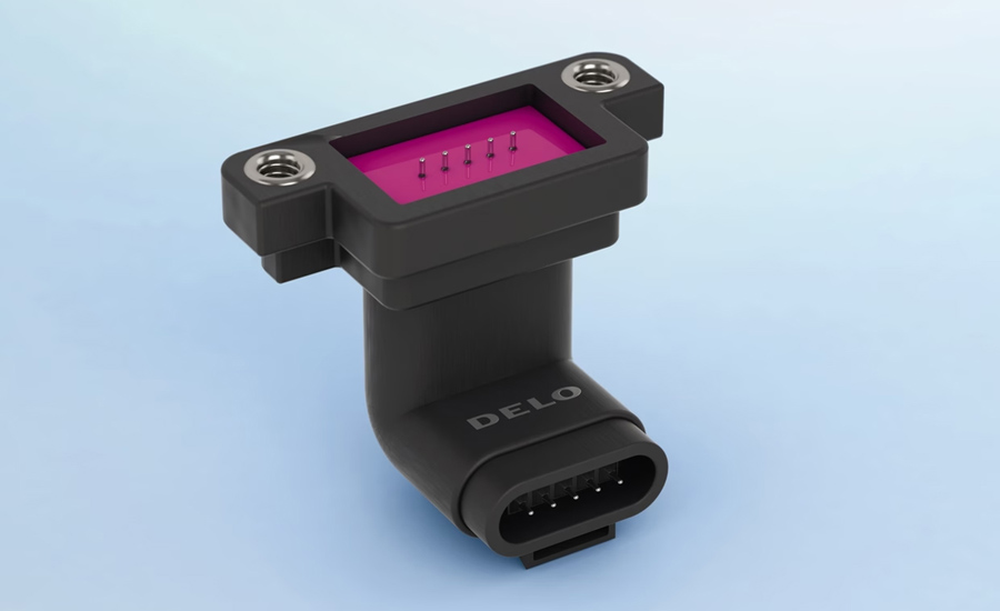

3D rendering of a sealed electronic connector with contact pins, mounting points, and integrated adhesive sealing for automotive and industrial electronics applications.
Dualbond GE is a dual-curing sealant (shown here in pink) that reliably seals connectors with passivated silver pins. Such connectors are typically used in automotive control units. Source: DELO Industrial Adhesives

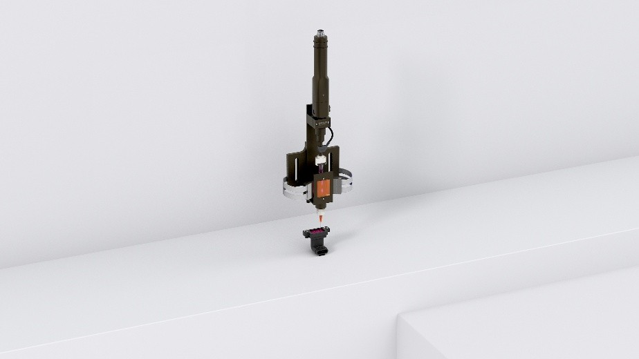

An alternative method is “activation on the flow.” Here, the UV-cure adhesive is exposed to light during dispensing. This begins a 5- to 10-minute open time during which the sealant has both good flowability and sufficient wetting ability to seal the entire cavity. The sealant then cures to final strength without further steps. Immediate further processing is possible if exposed sealant is exposed to additional light after assembly. This creates immediate initial strength and prevents the sealant from flowing out of the joint.
Automated dispensing system applying adhesive to an electrical connector component during a precision sealing and assembly process.
In “activation on the flow” curing, the adhesive is exposed to UV light as it is being dispensed. This begins a 5- to 10-minute open time during which the sealant has both good flowability and sufficient wetting ability to seal an entire cavity. The sealant then cures to final strength without further steps. Source: DELO Industrial Adhesives
