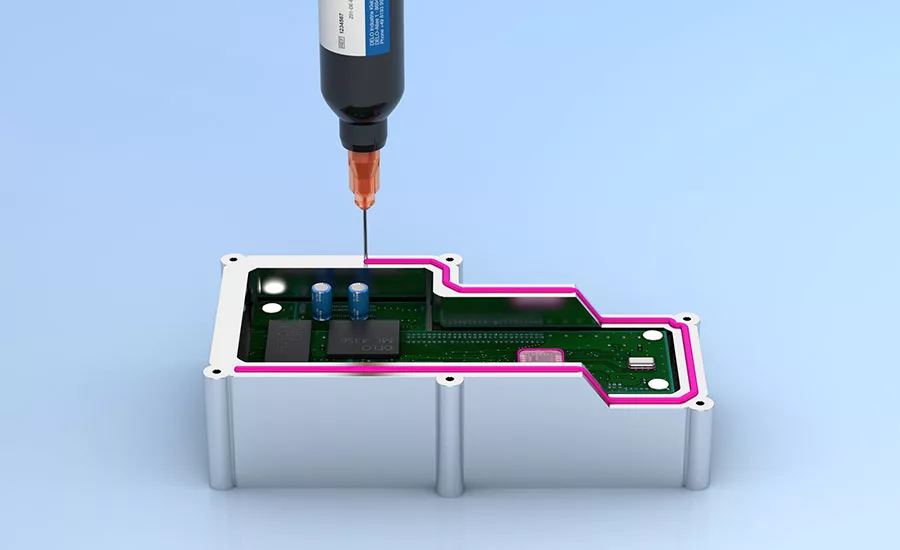

Dispensing Issues
Liquid gaskets are supplied in containers ranging from 50-milliliter tubes to 50-gallon drums.
Although liquid gaskets can be dispensed with handheld applicators, they are most often dispensed with automated equipment.
One way to apply liquid gaskets automatically is with a silk screen or stencil. This technique works particularly well with anaerobic adhesives and with applications that do not require a thick bead. Of course, for this technique to work, the entire bond line must be flat and even. Another way to dispense gaskets is with a six-axis robot or an X-Y-Z table equipped with an automatic valve. If the material is a two-component adhesive, a positive-displacement metering and mixing system will also be needed. And, if the adhesive is supplied in bulk, a pump will be necessary.
Because liquid gaskets are thick, a dispense valve capable of handling high pressure is desirable. This will ensure a smooth start to the bead, instead of a surge that creates a "cobra head" pattern. Similarly, the valve should provide a clean cut-off with "suck back," to prevent stringing or tailing at the end of the bead.
A spool valve is a good choice. Because its upper and lower seals are the same size, pressures within the valve balance out. High pressure will neither force the valve open nor make it difficult to open.
