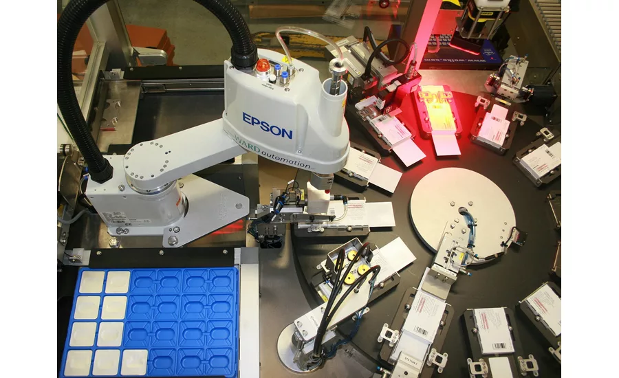

Run both joints as close to 100 percent capacity as possible. Doing so will enable the robot to cover more distance faster, says Phil Baratti, application engineering manager for EPSON. Optimum cycle time is achieved by joint one making one-third of the robot’s motion and joint two making two-thirds.
To optimize throughput on large works areas, use a robot, such as the RS-SCARA Plus from EPSON, capable of traveling through its work envelope. Because joint two clears joint one, this type of SCARA robot can go through its work envelope rather than around it. The robot’s motion range is 450 degrees on each axis, enabling it to depart or enter a point from any direction.
Lighten tooling and payload wherever possible. Applying this principle to mini SCARA robots can cut cycle times by as much as 0.1 second over a 50-millimeter work area, says Baratti. This tip also applies to six-axis robots.
Use a long-joint robot to cover a longer linear distance faster. On this robot, joint two is longer than joint one and twice as fast. It also has a larger inside working area than standard SCARA robots.
