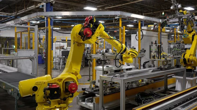

Photo courtesy Edgewater Automation
 Automated consumer goods assembly system featuring multistation processing and material handling designed to optimize cycle time and throughput.

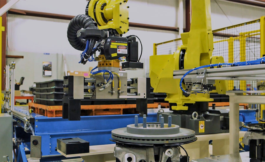

automated brake assembly system
Automated brake assembly system integrating precision assembly, inspection and material handling to maintain consistent cycle times in high-volume production. Photo courtesy Edgewater Automation
