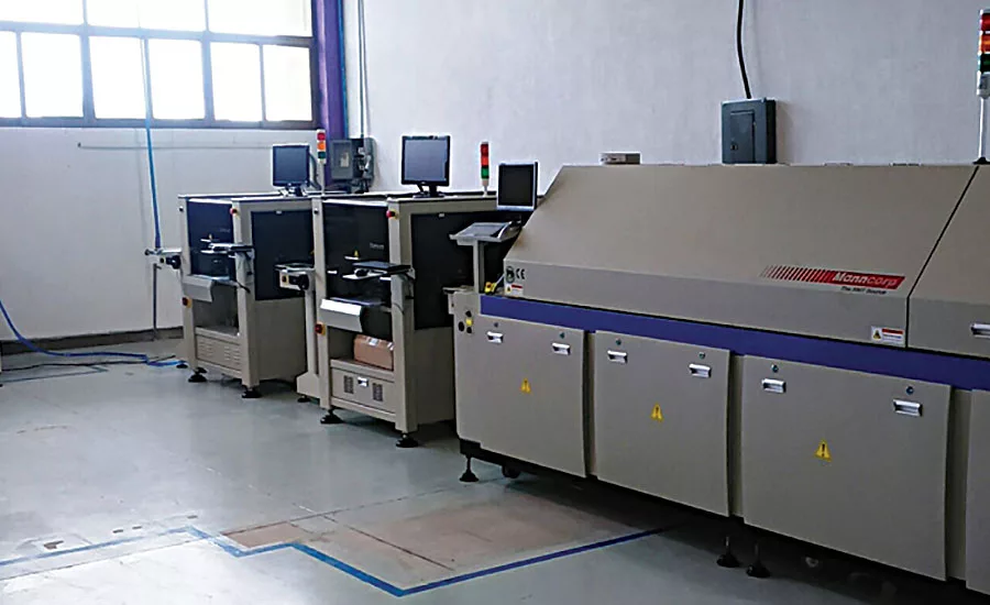

Last year, a PCB production line was installed at the rapid prototyping lab of the Instituto Tecnológico Superior de Zapopan. The line features two MC-385V1V pick-and-place machines, a PB2300 stencil printer and a CR-6000 reflow oven. Photo courtesy Manncorp

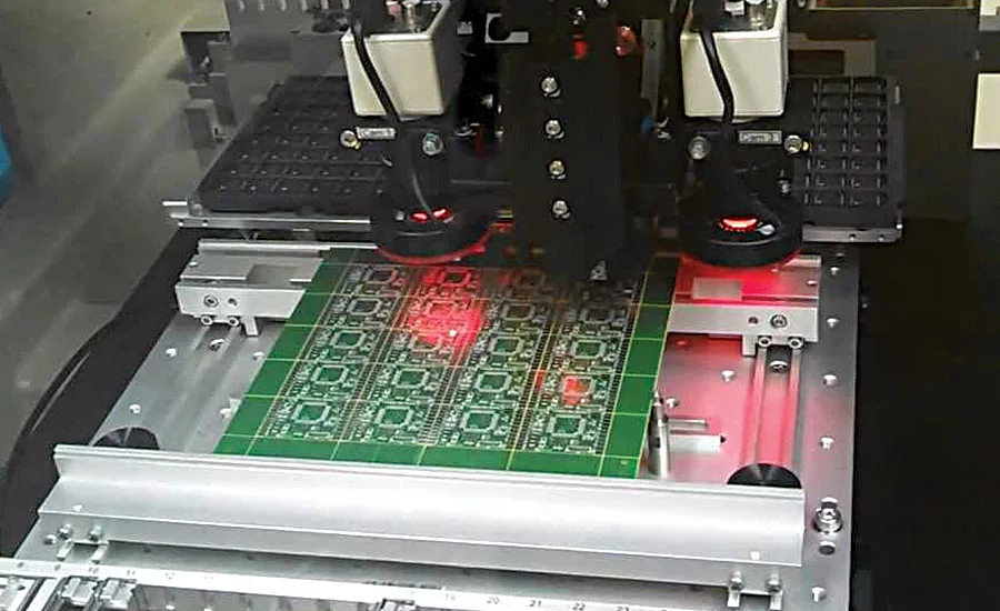

MC-385V1V pick-and-place machines are able to place a wide range of surface-mount devices, including 01005 chip components, ball-grid arrays and ultra-fine-pitch devices up to 150 millimeters square. Photo courtesy Manncorp

At the 3D rapid prototyping lab (Electromecanica Centro De Manufactura Avanzada Y Prototipado 3D), ITSZ and Continental engineers work together to develop innovative new products. Last year, Manncorp supplied the lab with a PCB production line offering flexibility and quick changeover.
The line features several pieces of surface mount technology (SMT) equipment, which were installed by Sabino De La O, sales and technical support manager for Manncorp in Juarez, Mexico. Two MC-385V1V pick-and-place machines have a high feeder capacity (128 slots each) and the ability to place a wide range of surface-mount devices. These include 01005 chip components, ball-grid arrays and ultra-fine-pitch devices up to 150 millimeters square.
A PB2300 stencil printer allows easy stencil and toolless squeegee changeover, while providing excellent repeatability and print results. The unit provides a print area of 480-by-400 millimeters and a frame capacity from 300-by-300-by-18 millimeters to 600-by-600-by-33 millimeters. Dual high-magnification CCD cameras, paired with twin LCD displays, enhance accuracy.
The production line also includes a full-convection, lead-free CR-6000 reflow oven with small footprint (13.6 feet long). It comes standard with a pin conveyor installed over a mesh belt that maximizes flexibility and handles PCBs up to 450 millimeters wide.
Independent upper and lower PID temperature controls (for each of six heat zones) and three thermocouple inputs ensure accurate temperature profiling. An optional internal, water-chilled, recirculating heat exchanger provides rapid, controlled cooling of liquidus lead-free solders.
