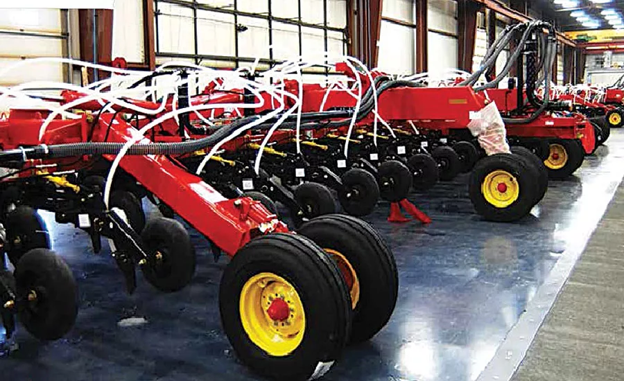

When assembled tillage equipment reaches the end of the assembly line, it is rolled off. Photo courtesy Bourgault Industries

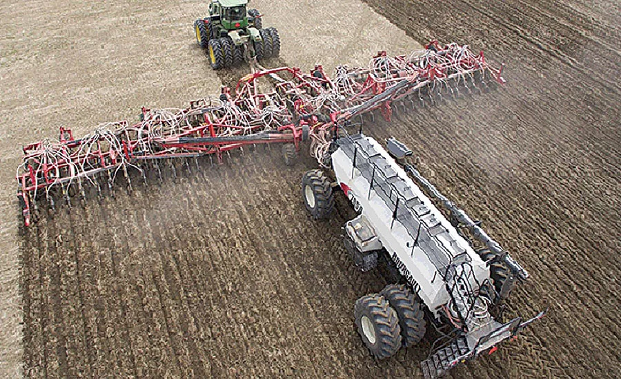

Bourgault Industries manufactures pneumatic seeding and tillage equipment that can reach widths of 125 feet and weigh more than 75,000 pounds. Photo courtesy Bourgault Industries

Today, Bourgault proudly showcases the moving-floor assembly line that has been installed at the facility. The line is 375 feet long, 25 feet wide and weighs in at just under 1 million pounds. It is specifically designed for manufacturing the company’s pneumatic seeding and tillage equipment, which can reach widths of 125 feet and weigh more than 75,000 pounds.

The assembly line consists of 37 wheeled carts that are queued together to form a continuous floor that is pushed along on rails by a pair of servo-controlled hydraulic cylinders. Each cart measures 10 by 25 feet, has a durable steel plate surface, and weighs 9,000 pounds.
Carts are not propelled individually. Rather, the cylinders push the first cart, which then propels the entire line of carts. A proportional-integral-derivative controller with position feedback enables precise velocity and acceleration control of each cylinder.
Floor speed can be set from 0.125 to 3.25 fpm, as production requires. Moving from the beginning of the line to the end can take as little as 1.75 hours or as long as 45 hours. When assembled equipment reaches the end of the line, it is rolled off. The cart, meanwhile, gets lowered below the assembly line and is transported along an underneath treble-rail system back to the front of the line for reuse.
