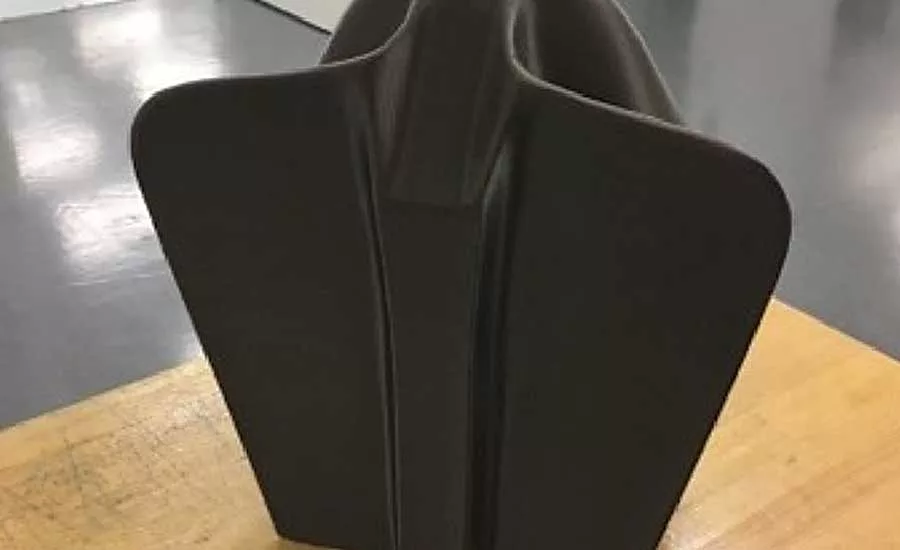

The mandrel 3D printed with Stratasys ST-130 sacrificial wash-out material keeps riders legs in place. Photo courtesy Stratasys

3D printing technology is everywhere, from medical implants to aerostructures, and recently it’s made its way to the Olympics. USA Luge teamed up with Stratasys, a supplier of additive manufacturing technology, to build customized racing sleds. Through their fused deposition modeling (FDM) technology, Stratasys printed key layup and sacrificial tools used for manufacturing the sleds. The technology was also used to make mandrels for the sleds—a composite structure used to properly position riders’ legs at the front of the sled.
“Competitive luge racing is an extremely demanding sport where fractions of a second are the difference between winning and losing. Our riders depend on comfortable, aerodynamic sled designs to win races,” says USA Luge technical programs manager Jon Owen. “In teaming with Stratasys, we’ve become much more competitive on the world stage—continuously adjusting designs and running them on the track much faster than traditional processes. Additionally, we’ve balanced both comfort and performance by tailoring the sled to each rider’s body, while minimizing fabrication cost and time.”
Leveraging the Stratasys ST-130 sacrificial (wash-out) tooling material, team designers were able to 3D print the mandrel; layup and cure the composite structure; and wash-out the tooling material—all in less than one week. Team USA has pushed the technology even further by 3D printing the entire sled body layup tool. This particular design incorporates a removable middle section, allowing tool length to adjust based on each rider’s height. Driven by these efforts during prototyping, designers are currently using this same tooling for final sled components during competition.
