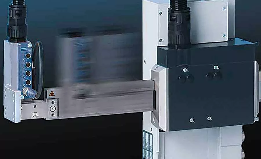

Electric EPS giga YZ and tera YZ actuators are designed for high payloads and fast, precise picking and placing. Photo courtesy AFAG Automation AG

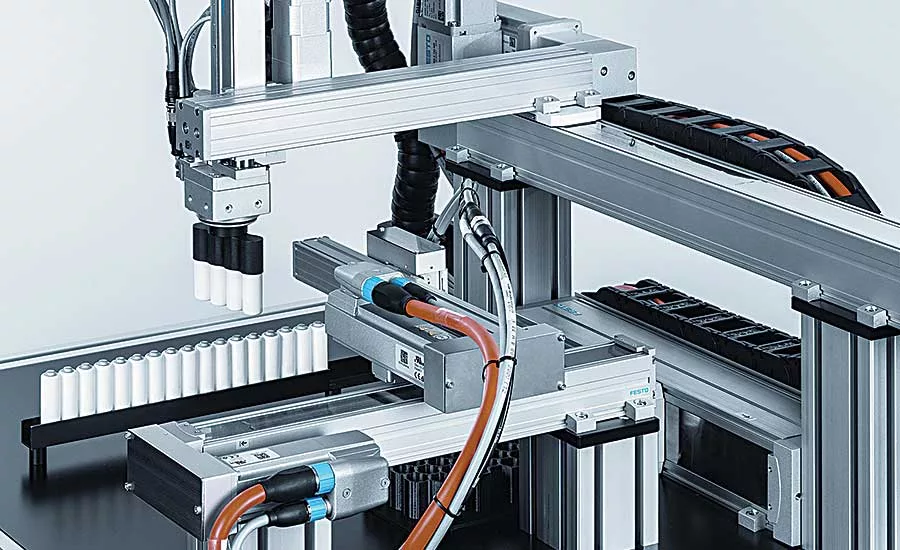

Pneumatic ELGC linear axes feature a protected recirculating ball bearing guide, making the units ideal for X, Y and Z movements. Photo courtesy Festo Corp.

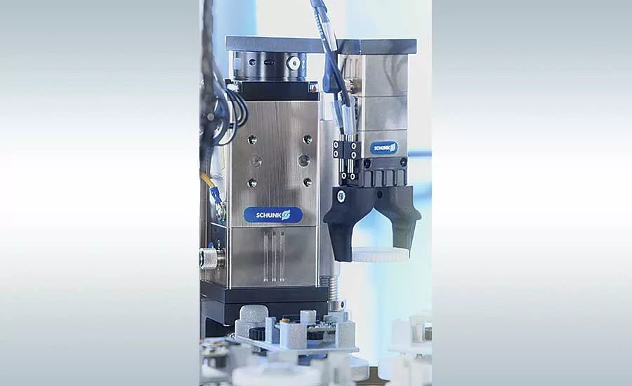

The EGS rotary gripper module grips small- to medium-sized workpieces in standard and clean room environments. It is digitally activated by binary signals and performs at high speed with an adjustable gripping force. Photo courtesy SCHUNK

SCHUNK’s PPU-P pick-and-place unit offers the best of both worlds. It’s pneumatic, but it also uses a cam to control the motion.
The unit can operate at up to 120 cycles per minute. With a 145-millimeter horizontal stroke, a 45- millimeter vertical stroke, and up to 1 kilogram of moving mass, the unit can achieve a cycle time of up to 0.63 second—including the 100 milliseconds of total time to open and close a gripper.
The pick-and-place module is actuated via two double-acting pneumatic cylinders that are integrated in the slide. The cylinders are aligned 90 degrees to each other. The unit’s horizontal and vertical motions overlap and are smoothed by a cam roller that is positively driven in a curve. Both horizontal and vertical motions can be actuated sooner, and cycle times can be shortened. The horizontal stroke can be adjusted by up to 12 millimeters per side. Both vertical end positions can be adjusted by 15 millimeters, independently from each other.
SCHUNK integrated a smart feature for synchronizing the PPU-P with upstream or downstream equipment. Thanks to the control unit, a gripper can be placed directly over the individual target position and be actuated through the standard control interface. This feature helps make the unit faster and more reliable.
When the PPU-P is equipped with an optional intelligent valve box, its efficiency increases even more. The valve box minimizes consumption of compressed air. The optimum circuit of both drive cylinders is already preadjusted. Up to four additional valves directly control auxiliary pneumatic devices, such as grippers and rotary actuators. Thus, all the valves are comfortably and economically supplied with air from a single line.

“Linear motors are very fast with no backlash. [They’re also] easy to program, maintain and replace when needed,” says McBride. “Some motors, like the Linmot models we use in our EPS actuators, only require a single motor cable to connect the actuator to the controller. This cable includes the motor phases and receives signals from the position sensor integrated in the motor.”
AFAG’s EPS giga YZ and EPS tera YZ are designed for heavy payloads and fast, precise applications. The giga YZ can move a maximum payload of 15 kilograms, and the tera YZ can handle 20 kilograms. In 1.5 seconds, these systems can move a 10-kilogram payload 100 millimeters on the Y axis and 100 millimeters on the Z axis. Gripping time is 100 milliseconds.

For applications where compact dimensions are essential—such as handling small parts in electronics assembly—Festo offers the ELGC linear axis unit and the EGSC mini slide. They feature a common platform architecture and bolt together without an auxiliary adapter plate.
Arnold says the ELGC’s protected recirculating ball bearing guide is ideal for X, Y and Z movements. The resilient slide, with quiet spindle operation, is ideal for Z movements or guided linear movements in any mounting position.
