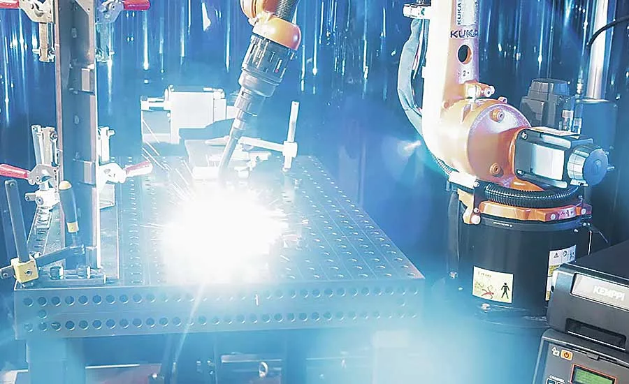

The term, “payback period,” does not actually describe the profitability of an investment; it just describes the time needed to “repay” the amount of money used for the investment. Photo courtesy Kemppi Oy

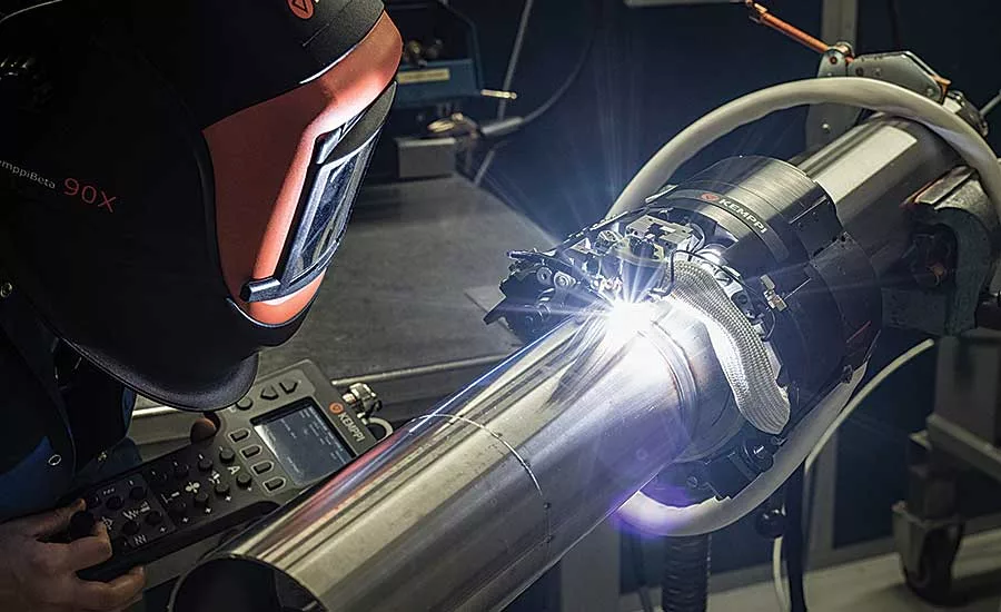

The value of a welding robot can be measured by the sales value of joints it produces during a set time period. Photo courtesy Kemppi Oy

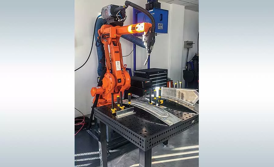

If engineers and management conclude that a task cannot be done without automation, then using labor cost as a basis for comparison and as an element in ROI calculations is more or less irrelevant. Photo courtesy Kemppi Oy

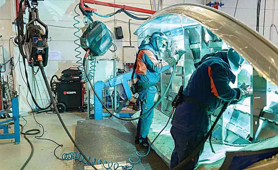

Any investment in new machinery will involve more than just the equipment itself. Production planning and scheduling may need to be modified for the new production concept. Photo courtesy Kemppi Oy

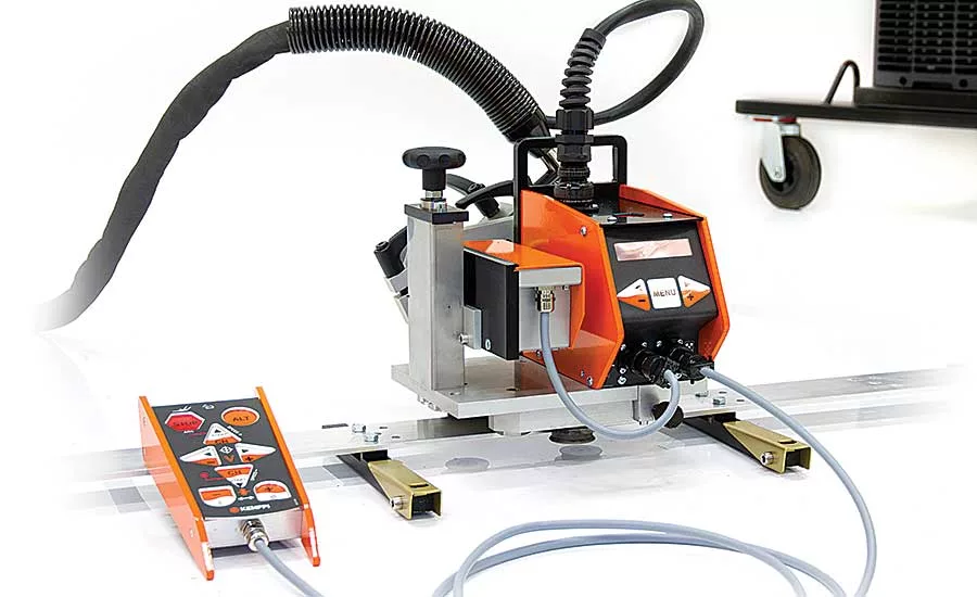

The preferred tool for evaluating the profitability of an equipment investment is one that uses net present value (NPV) instead of—or in addition to—the calculation of “payback time.” Photo courtesy Kemppi Oy

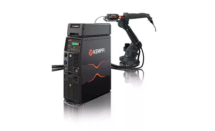

Buster Boats uses MIG and TIG welding equipment from Kemppi Oy to weld its aluminum boats. Photo courtesy Kemppi Oy

Production engineers often get excited about new technologies and tend to think that the benefits of investing in them are obvious to everyone else in the company. However, enthusiastic engineers can get an unpleasant surprise if they are not prepared to argue their case properly.
Whenever engineers seek to add a new technology to the shop floor, management invariably asks the same question: What is the payback period of the proposed investment? That’s a fair question, but it’s worth pointing out that “payback period” does not actually describe the profitability of an investment; it just describes the time needed to “repay” the amount of money used for the investment. It does not take into account the time value of money, the risks involved, opportunity costs, and other factors.
Therefore, the preferred tool for evaluating the profitability of equipment investments is one that uses net present value (NPV) instead of—or in addition to—the calculation of “payback time.” Internal rate of return (IRR) or calculations based on annuity can also be used.

Earnings represent the net increase in customer value that the investment provides. For example, in the case of a welding robot, it can be the sales value of welded joints produced during a time period. Thus, it’s easy to see that the feasibility of an automation investment depends heavily on a high utilization rate. In the case of robotic arc welding, one robot can produce 6,000 to 12,000 kilograms of welds per year, while one manual welder can only produce 1,500 to 2,000 kilograms of welds annually. If we assume that the customer pays the same amount of money per kilogram of welded material, the earnings are easy enough to estimate for both concepts.

The last point is not an actual cost factor, but a fundamental fact to be recognized: Can the job be done without automation? Can the targets for production volume and profit be reached when considering accuracy, quality, speed, the health and safety of workers, the general availability of skilled workers, and limitations on floor space, storage space and material flow.
If the conclusion is that the job cannot be done without automation, then using labor cost as a basis for comparison and as an element in ROI calculations is more or less irrelevant.

To understand the impact of investments in automation, a wider perspective should be taken. Any investment in new machinery will involve more than just the equipment itself. Production planning and scheduling may need to be modified for the new production concept.
