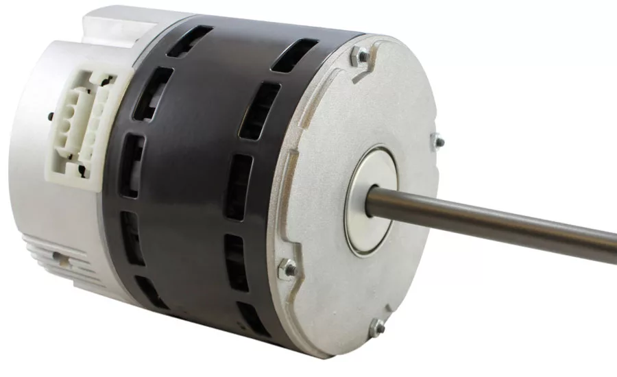

This is a full communicating constant CFM furnace ECM. Source: Nidec

Unlike PSC motors, BPM motors have electronic speed and torque controls built in. They are electronically controlled to ensure optimal airflow for given conditions. The controls are designed to convert single-phase energy to three-phase power, and by modifying the waveforms input to the motor, it is possible to achieve approximately 20 percentage points more efficiency than single-phase PSC motors, even at peak conditions.
Because these motors are driven by electronics, it is also possible to program their speed and torque through the electronic controller incorporated into the motor. That is good news to OEM product developers, who can simply define the desired torque and speed settings they want in a motor. The electronic controller is plugged into a computer, which “communicates” to the electronic drive and programs those settings into the motor automatically. If a speed or torque change is needed, the motor can simply be reprogrammed.
Because BPM motors have the same size diameter as a standard furnace PSC motors, they can also be incorporated into most furnace fans without additional design changes to the OEM’s furnace.
