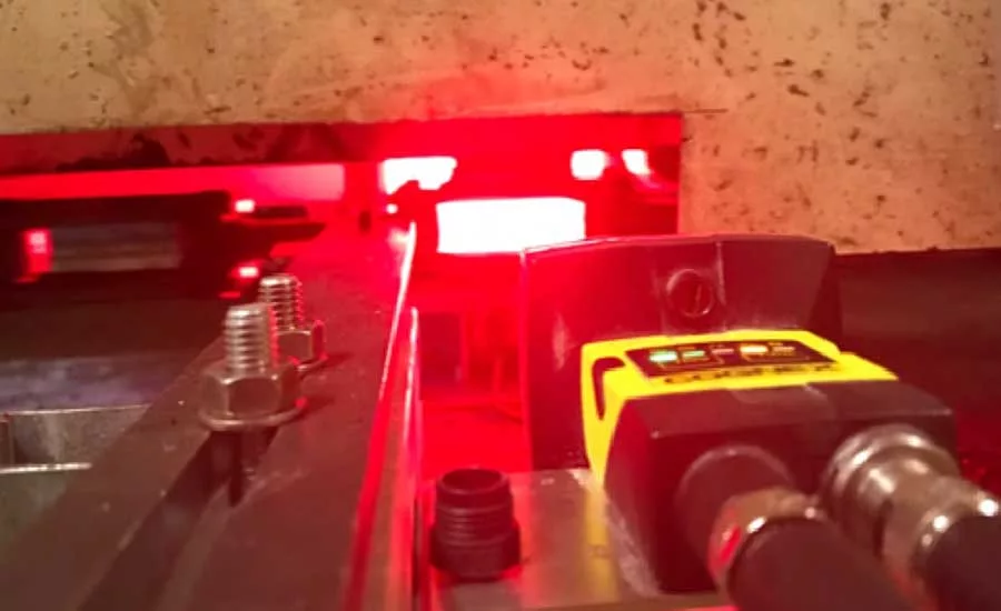

Chain-link inspection involves using an LED illuminator to backlight the chain, having a camera take several images of the link and then having software analyze the images for stretch variation. Photo courtesy Cognex Corp.

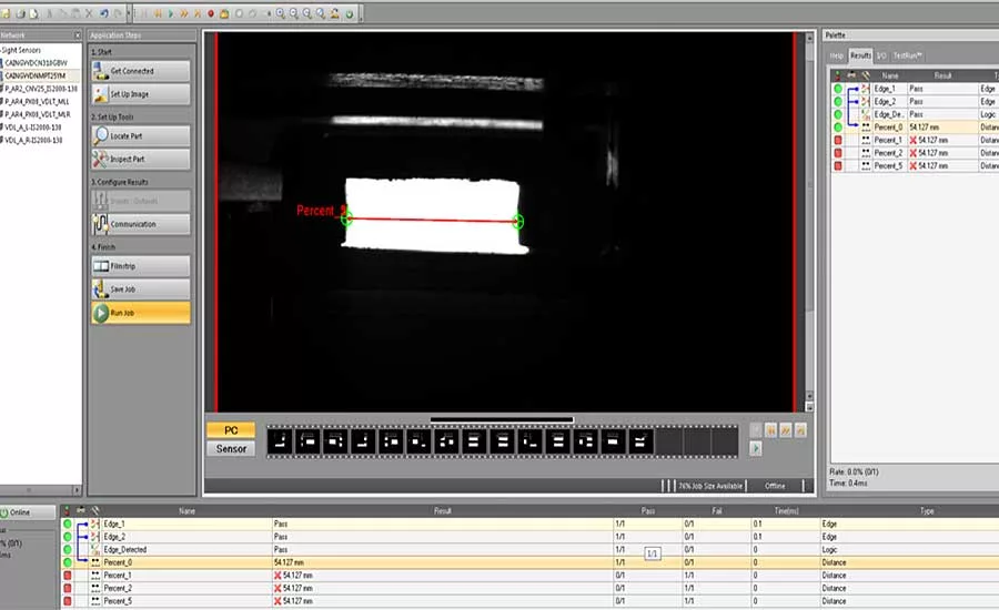

Image-analysis software shows the internal length of a component, as well as whether or not it has passed or failed inspection. Photo courtesy Cognex Corp.

After that, the engineers worked closely with vision specialists at Cognex Corp. Together, they developed an In-Sight 2000-vision-sensor-based system that measures the stretching of every chain link in real time and automatically marks noncompliant links without slowing or stopping the line.
The system consists of vision and proximity sensors, a red LED illuminator, a red filter and image processing software. As the illuminator backlights the chain—to provide a crisp outline of the link under inspection—the filter helps eliminate the effects of ambient light and the proximity sensor triggers the camera to take several images of each link when it is within the field of view.
After this, Cognex In-Sight Explorer image processing software uses edge-detection algorithms to identify the center of each chain link. A caliper tool then measures the link’s internal length.
“Basic pass-fail inspections can be accomplished with intuitive, point-and-click setup tools,” says Christopher Eid, a system designer at GM Canada’s electrical engineering paint department. “In this case, when edge detection finds both link edges, the distance between the two connections is measured, and the result is placed under the respective chain-stretch limit category. The HMI displays the relevant information.”
Caliper measurement data helps GM engineers determine each link’s percentage of stretch variation. When the variation reaches 4 percent or higher, the vision system sends a signal to a nearby PLC through an optional Cognex I/O module.
