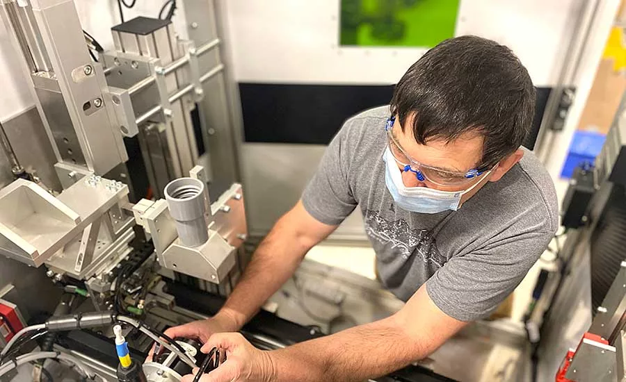

Manufacturing technician Christopher Lord adjusts a mechanism inside an automated assembly system. Photo courtesy Lanco Integrated

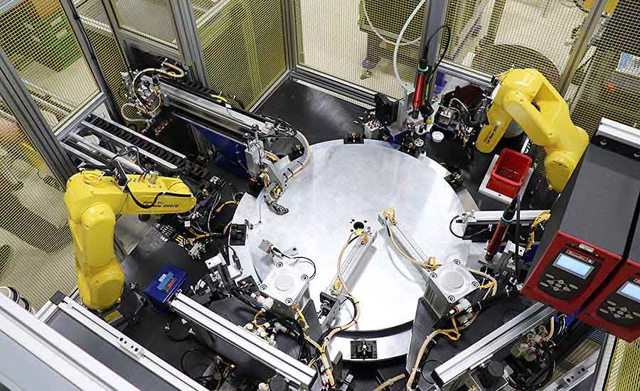

Robots are frequently reused in automated assembly systems. Photo courtesy Edgewater Automation
