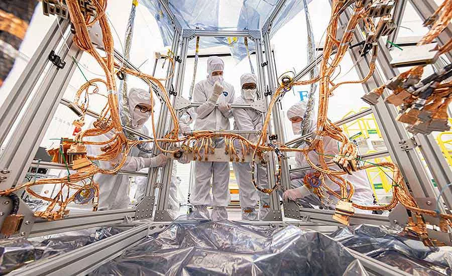

To assemble the harness, APL built a full-scale fixture that matched the curved surfaces of the spacecraft’s body. The harness could not be built on a traditional form board, because it would be wrapped in copper foil. Photo courtesy NASA

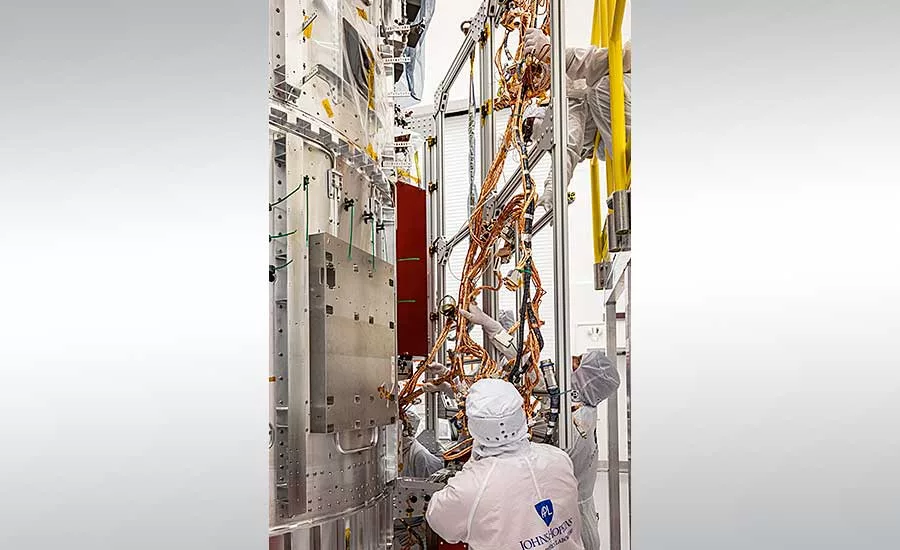

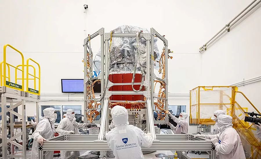

In a clean room at APL, Europa Clipper’s propulsion module harness is transferred from the fixture to the spacecraft. Photo courtesy NASA

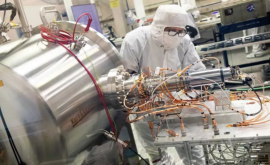

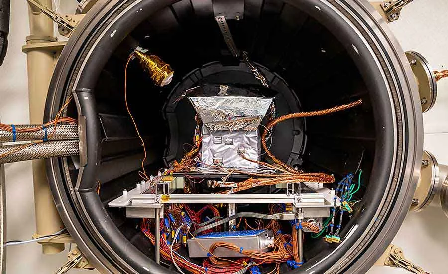

A plasma instrument sensor assembly is loaded into thermal vacuum chamber for testing at APL. The large number of wires that are visible demonstrate the intricate setup for the test. Photo courtesy NASA

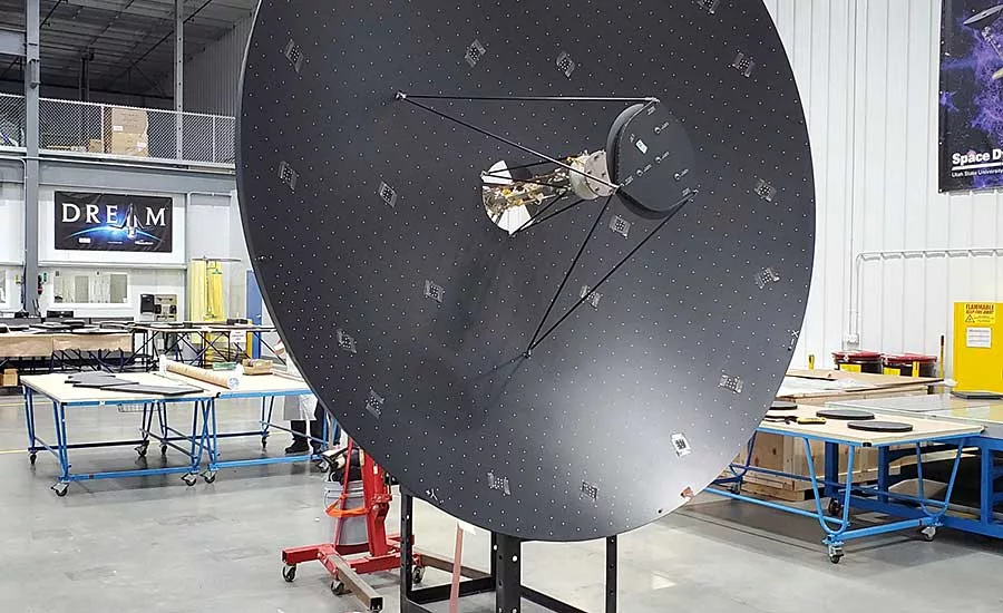

Nearly 10 feet wide, the Europa Clipper’s high-gain antenna will send scientific data to Earth and allow ground controllers to send commands to the spacecraft.Photo courtesy NASA

To assemble the harness, APL built a full-scale fixture that matched the curved surfaces of the spacecraft’s body. “We could not build the harness on a form board, because it would be wrapped,” Perry explains. “If we wrapped it flat and then tried to mount it in this curved configuration on the spacecraft, it would not have worked. We needed to wrap the harness in the shape it would be on the spacecraft.”

After baking, the fixture was mounted to a custom-built cart, which was wheeled into place and elevated into position next to the spacecraft. “The fixture gave the spacecraft an ‘air hug,’” she explains. “Then, we carefully transferred it from the fixture to the spacecraft. We stopped a lot to talk about who is doing what and when. There was a lot of coordination. Everyone had assigned roles. We had tie-downs preinstalled to receive the harness.”
