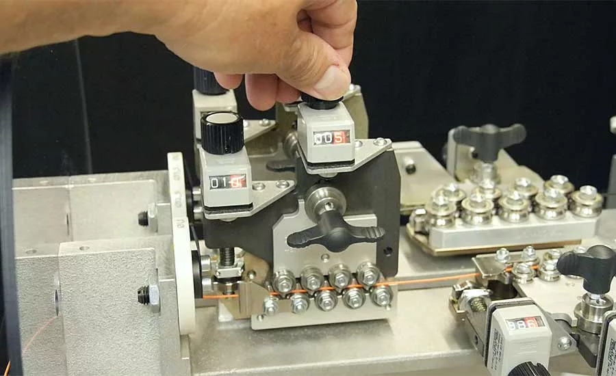

Wire straighteners can eliminate problems caused by curling. Photo courtesy Schleuniger Inc.

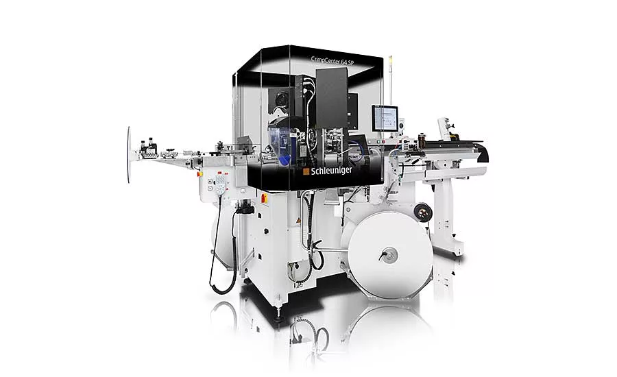

Even the most advanced equipment in the world can be susceptible to problems if it isn’t programmed correctly. Photo courtesy Schleuniger Inc.

“If there’s a lot of curl in the wire, it’s more difficult, because all machines are designed with the idea that the wire is going to be straight,” Boyd points out. “Sometimes, when wire comes off a spool, it will wrap around the blade. Although many machines are equipped with wire straighteners, they can only do so much.”

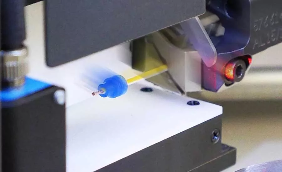

WireCam monitors stripping results and certain properties of positioned seals. A camera takes a picture of the processed wire end while it’s in motion. Based on a two-dimensional top view picture, software inspects each single wire end and compares it with a reference image in real time.

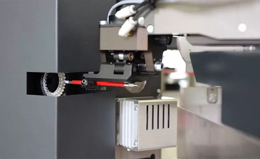

Schleuniger’s CoaxCenter 6000 is equipped with QCam 360, a camera system that checks the cable ends. It inspects 360 degrees around all sides of a cable. Reject parts are sorted out immediately and automatically reproduced.
