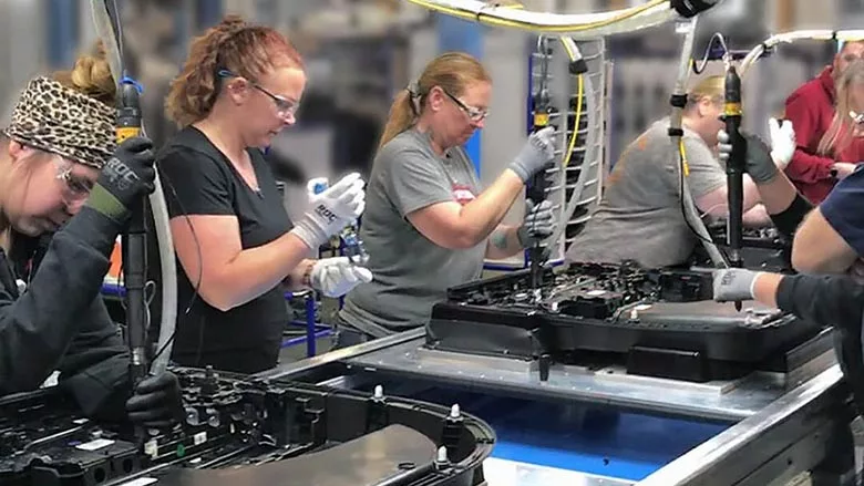

Many screwdriving problems are caused by simple operator error. And, as some veteran engineers have discovered, most of the same mistakes from the past are still being made today. That’s often due to a lack of training caused by labor shortages and high turnover rates.
“For automatic screwdriving systems, one of the biggest mistakes that operators make is not maintaining adequate pressure on the driver to keep the bit engaged with the screw while the screw is being driven, resulting in the bit camming out or surface driving the screw,” says Buckner. “Either condition may cause improper tightening and premature bit wear, along with damage to screw heads.
“Engineers should consider the torque limitations of the screw drive type, as well as selecting a screw design that allows for full bit engagement,” suggests Buckner. “Allowing adequate room around the screw location to make it easier for operators to access is critical as well. Screw locations that are difficult to access will inevitably have more problems driving screws.”
“Some operators, especially if they’re new, don’t always allow the screw run down process to complete,” says Visumatic’s Neff. “They drive a screw maybe 95 percent of the way and then lift up before the cycle is complete. That will leave them with either a high screw or a joint that’s not fully tight.”
“The biggest mistake that operators make is not allowing the screwdriver to finish its job and drive to torque,” adds Deprag’s Baeumler. “To prevent this, we offer a process control function in all of our platforms. This ensures that an operator lets the screwdriver finish one process before they can start the next.”
Another mistake, especially with standard mechanical clutch electric or pneumatic drivers, is grabbing the wrong tool for the application. Some operators also make changes to the driver to increase torque output, thinking it will make things easier.
screwdriving tools
The type of screwdriving tool being used can influence throughput. Photo courtesy Visumatic Industrial Products Inc.
“I’ve seen many facilities that have five or six screwdrivers hanging above a workbench all calibrated to a different torque spec,” says Wagner. “I have watched operators just reach for one and then get called out for running the wrong driver for a specific torque.
“I have also watched operators encounter running or prevailing torque due to thread issues or debris, then turn the torque up on the driver just to get the fastener to drive all the way in, and then occasionally break screws or parts in an assembly,” notes Wagner.
