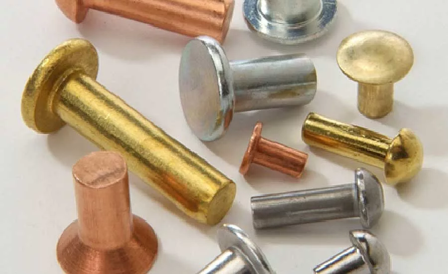

Small rivets have a shank diameter of 2 to 3.5 millimeters (0.079 to 0.138 inch) and may be blind (open end), solid, tubular, semi-tubular or split. The shank typically doesn’t exceed 3 inches in length. Micro rivets have a shank up to 2 millimeters wide and 5 millimeters (0.197 inch) long.
Small rivets are made of steel, stainless steel, aluminum, brass or copper. Custovic says Stanley’s micro rivets have an aluminum head, with a steel or stainless steel mandrel. Stainless steel rivets are recommended for medical products due to its corrosion resistance.

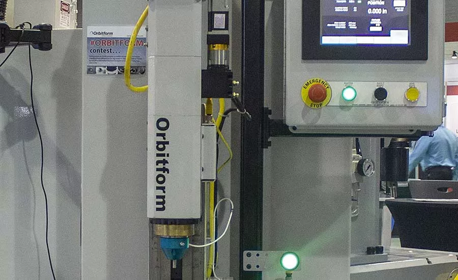

BalTec makes several radial forming machines for rivet installation. Radial riveting is a cold forming process that uses a peen tool on a rotating spindle. The tool moves at a 2- to 6-degree angle, depending on required tool length, and moves in a rosette pattern on the rivet head to knead the material at a constant speed and uniform rate into the desired form.
Lytle says many manufacturers use BalTec’s ER-O3U electric servo riveting unit in conjunction with a rotary indexer for medium-volume part assembly with small rivets. The ER-O3U has a slimline design (with internal cable routing) and provides advanced process control for precise installation of rivets up to 0.079 inch in diameter. It produces a forming force of 0.3 to 3 kilonewtons, with a linear stroke up to 100 millimeters.
The unit measures rivet position via two independent systems, and its servo drives monitor motor temperature to optimize performance. Spindle lubrication is ongoing and controlled by software.
Orbital riveting differs from radial in one fundamental way, according to Wright. The spindle moves material at different rates, with that near the rivet’s perimeter moving faster and farther than material near the center.
“Certain application factors determine whether radial or orbital forming is best to install a small rivet,” says Wright. “Radial is a good solution when the rivet is small, has a relatively long shank and is challenging to access and secure during the forming process. Orbital is the preferred riveting choice in almost all applications because the orbital machine costs less to operate and maintain.”
Orbitform’s BSV-125 and BR-240 models are quite popular among manufacturers that install small rivets. Regular users include companies that make medical instruments, electronics, and window and door locks.
Recently, a surgical stapler manufacturer was using a press to assemble prototypes of a new product. Testing indicated tightness and torque inconsistency on each of the device’s three stainless steel riveted joints from part to part. This occurred because the amount of force applied during rivet forming was causing the rivet shank to swell, resulting in deformity of some components in the joint stack.
“We were asked to perform additional lab testing and determine the best riveting process to achieve consistent functional requirements of the stapler joints,” recalls Wright. “Radial riveting proved to be the process of choice, exerting the minimal amount of downward and side load force to successfully form the rivets. The lab testing also showed that it is best to form each rivet separately, rather than doing all three simultaneously, as was done with the press.”
To meet the company’s production requirements for the application, Orbitform provided a BR-240 radial riveting machine with an X-Y fixture slide package. Assembly now involves positioning the stapler under the BR-240’s riveting head at each rivet position before hand-activating the machine to install the small rivet. Ongoing benefits include damage-free and consistent joints, along with maximum production throughput.
