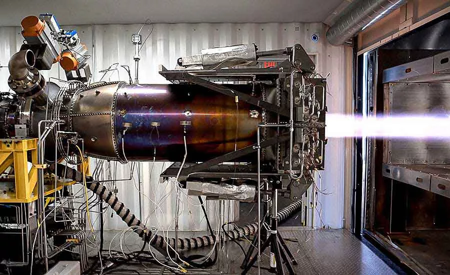

One hurdle was recently cleared when the Chimera engine underwent a series of successful tests at Notre Dame University’s Turbomachinery Laboratory. Heated air was used to simulate high-Mach temperatures and pressures.

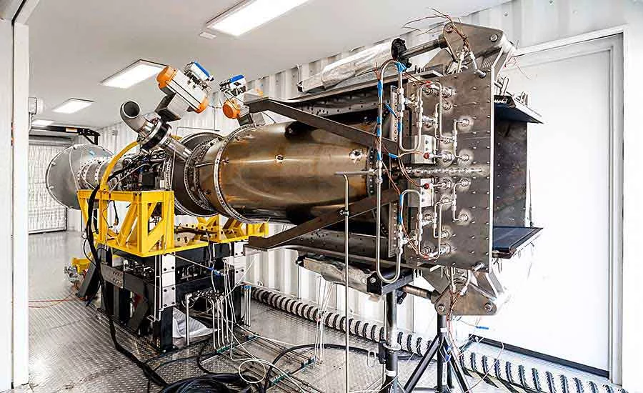

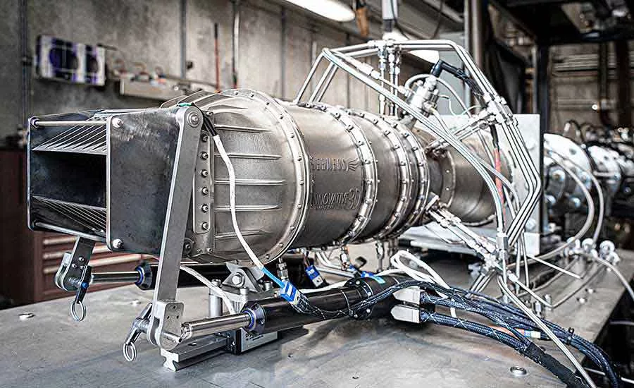

Chimera is a turbine-based combined cycle (TBCC) engine that is a hybrid between a turbojet and a ramjet. The ability to switch between these two modes will enable Quarterhorse to take off from a regular runway and then accelerate up to hypersonic speeds.
Hermeus engineers designed, built and tested the next-generation jet engine in 21 months for $18 million. Most observers predicted this technical milestone would take much longer and cost more money.

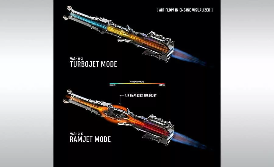

At low speeds, Chimera is in turbojet mode, just like any jet aircraft. But, as the temperature and the speed of the incoming air increase, turbojets hit their performance limit. This typically happens at around Mach 2.
Chimera has a pre-cooler that reduces the temperature of the air coming into the turbojet. This allows Hermeus engineers to squeeze out a bit more performance from the turbojet before transitioning to ramjet.
At around Mach 3, Chimera begins to bypass the incoming air around the turbojet and the ramjet takes over completely.
A ramjet is a simple propulsion system that “rams” the incoming high-pressure air to create compression. Fuel is mixed with this compressed air and ignited for thrust. Ramjets are optimal between Mach 3 and Mach 5.

Hermeus is relying on additive manufacturing technology to quickly produce complex metal parts. In fact, approximately 15 percent of the Chimera engine consists of printed components.

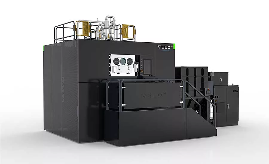

Hermeus uses Velo3D’s Sapphire and Sapphire XC machines. The latter is a large-format printer that is designed for high-volume production. Both machines are calibrated to print parts made out of Inconel 718.
Sapphire has a build envelope of 315 by 400 millimeters, while Sapphire XC is capable of printing parts 600 millimeters wide and 550 millimeters tall. Both machines are ideal for printing complex shapes that demand new materials and tolerances.

Hermeus is using the Sapphire XC machine to print large-format metal parts. Photo courtesy Velo3D Inc.
